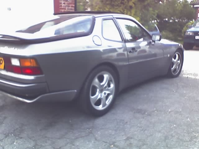

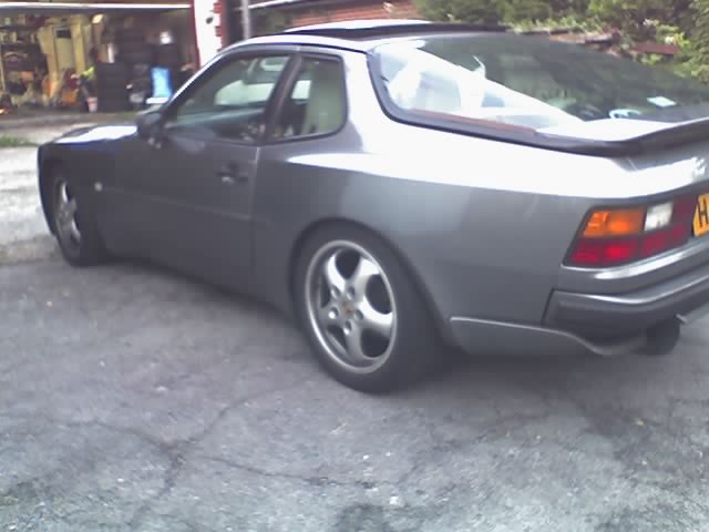

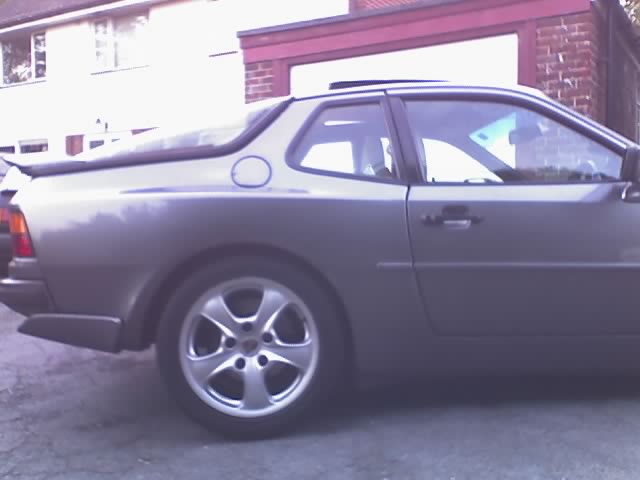

I run 993 8 j wheels et 30 on th back of my s2, the matching fornts (from a 993 carrear 4 s) were 7 j et 55. backs stick out mroe than the fronts so I am looking to space the fornts out for looks a bit, and aim for 6 mil spacers, which I am hoping will work ok with the original studs.
As a rule of thumb, with steel botls and studs, you shoul have a minimum of 8 full turns of the whels bolts / nuts, before they begin to pinch up. with the ally porker nuts, it may be better to have bit more, but 8 terms is what the wheel manufacturers told me then I was after some trci offsets for my golf.
