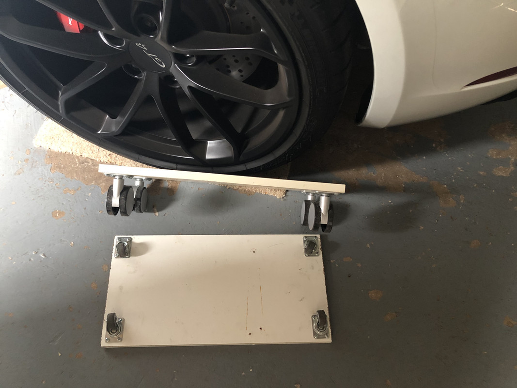

These home built wheel dollies also help moving the wheel off and back on. I made two as I had excess shelving available for the base and two sizes of dolly wheels in the garage. Only one actually needed, the smaller wheeled one works best for me.
I got the idea from 997 Forum FAQs (lots of good general information there)

As you say, the wheels are surprisingly heavy and cumbersome - and the trolley will make the job easier on your back!
