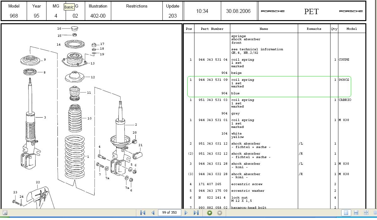

Got my springs today, I'm goind to have a go fittng them this week end. I'm not convinced they are the right ones as they have a 944 part number, the lad at OPC parts assured me they are correct, the part number is
944.343.531.09.904
which I find odd if they are supposed to be 968CS springs, they are black with 3 blue spots on them, can any body advise before I start dismantling my motor!! [:D]
Yes they are the correct ones Nick. I've pasted the requisite page from PET for the 968 here and highlighted the CS springs in a green box. Most 968 parts seem to start with a 944 or 951.

If they have blue dots on them, then they are CS springs... Each set of springs are colour "dot" coded... Blue, being 968CS ones...
