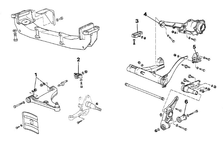

ORIGINAL: Jonny944CS
Part numbers for the Genuine M030 bushes (if still available)
Part # 1 - Front wishbone bushes (x4) - 951 341 041 31
# 2 - Rear wishbone bush (x2) - 951 341 023 01
# 3 - Torsion bar tube thrust mount (x2) - 951 331 088 30
# 4 - Rear trailing arm bushes (x4) - 951 331 059 30
I believe Hartech are also now offering their own versions of the stiffer bonded rubber front bushes.
As a side note just been looking these up in the 944 & 968 pdf katalogs. Those [front axle] rear wishbone bushes are the same part number for the 968. The torsion bar tube thrust mounts are almost the same number on the 968 but not exactly the same, 944 standard part completely different number. Neither katalog lists the front wishbone bushes hence why I asked about them.
