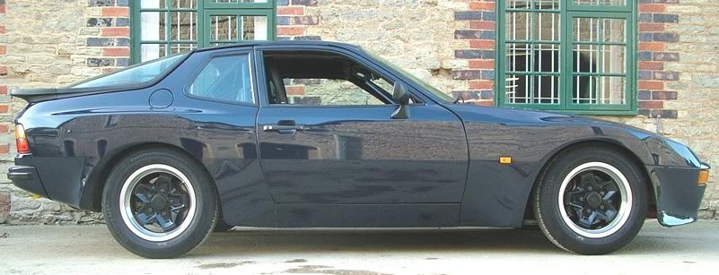

I set mine KW's to the lowest end of the factory 968 Clubsport ride height tolerance (the lowest specified for 4cyl road cars IIRC).
- Front caster mount bolt head face 157mm below the wheel ctr
- Rear torsion bar ctr 47mm below the wheel ctr
This sets the steering arms parallel to the ground, helping to minimise bump-steer effects and maintains the ball joints within their designed operating range. I find the same as Jon regarding speed humps and kerbs.
For track use I run 205/55/15 tyres which lower the car a further 15mm and sharpens-up the gear ratios.

They do but on my old car they set it with an aggressive nose-down attitude. Handled great but caused many problems for normal day to day driving, looked odd and suffered from terrible bump-steer (not necessarily a problem once you're used to it). I also had problems with headlight alignment as they couldn't be raised enough to achieve correct height so were pointing to the ground a bit. I had my Indy raise the front to flatten it out again ang it felt and looked much better for normal road driving. I would advise to lower it, but keep a flat attitude. I have no idea how much lower than the std ride height it was -std ride height seems to vary a lot anyway, but it was noticeably lower, but by no means slammed to the deck. A really nice set up I thought.
