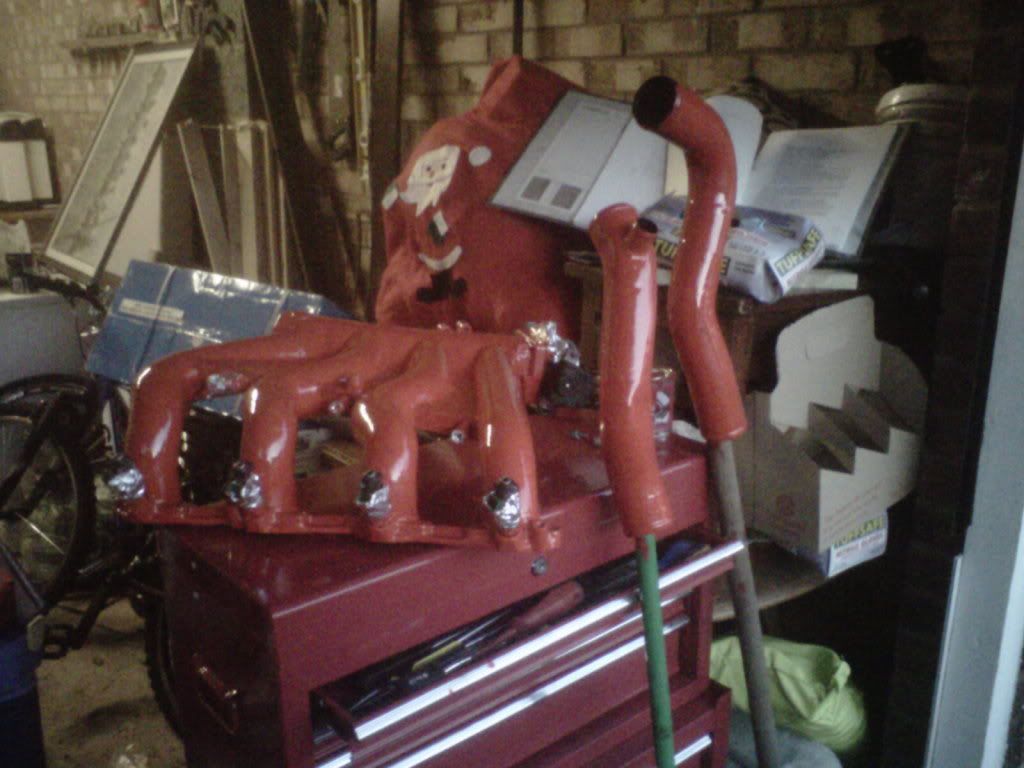

Inlet manifold painted along with the hard boost tubes.

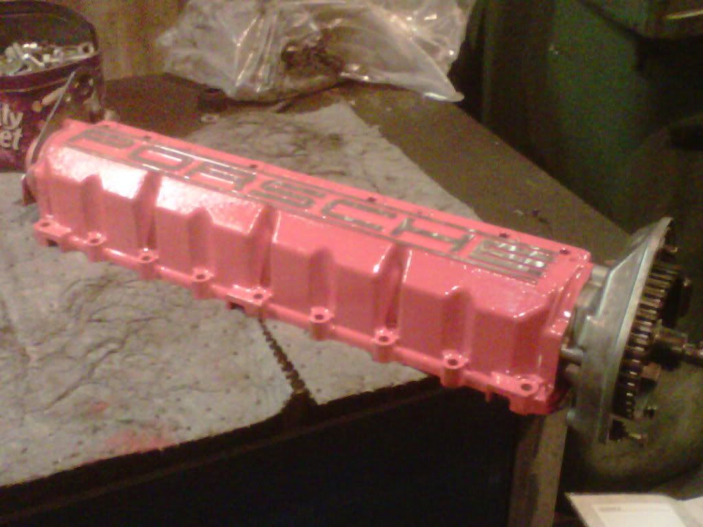

Camshaft tower fully refurbished and painted ready to go back on.
