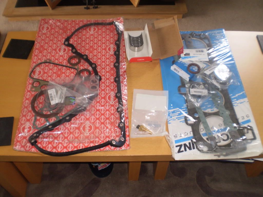

Haven't been able to get too much done the last couple of days due to the weather oh and my Stepdaughter giving birth lol [:eek:] Have manged to wrap the exhasuts though and paint the intake manifold (pictures to follow). I did get a nice parcel in the post this morning though [;)]
Hmmm precious things
Now if anyone could just tell me where they all go [&:] Although ProMax do offer a top notch service without question I would have loved to get an itemised list with each kit. Has anyone used their widefire HG and sump/bottom end gasket kits before and know exactly what is included? Oh and BTW yes that is my Spiderman slipper under the coffee table [:D]
