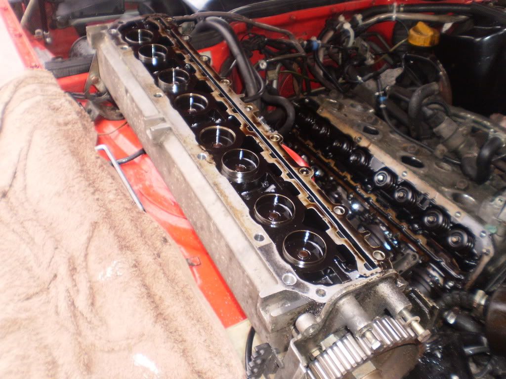

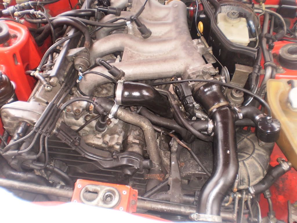

Inlet manifold off.

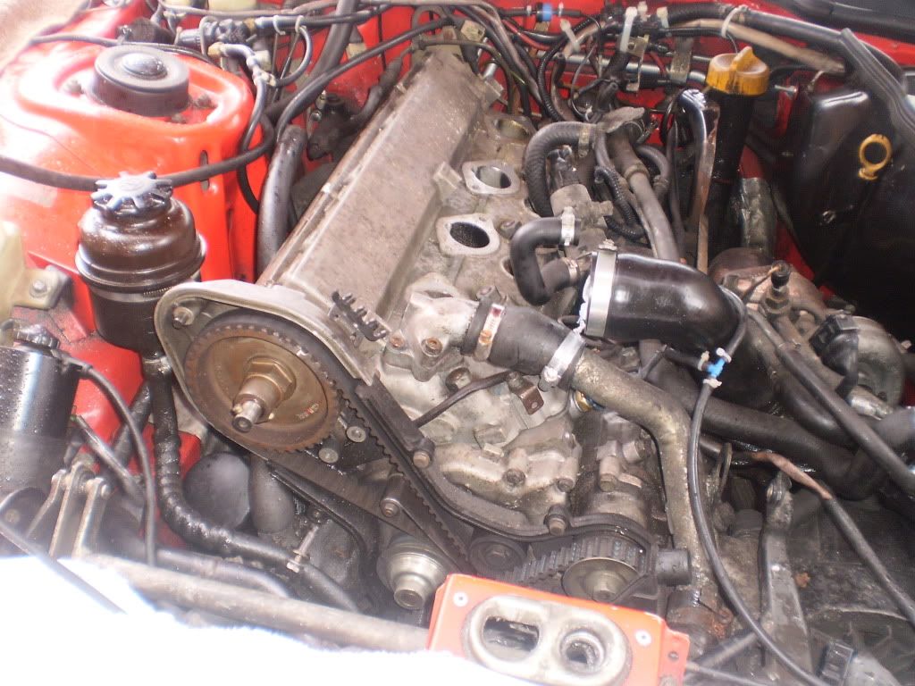

Ready for the cam tower to come off.
A finally it's off.

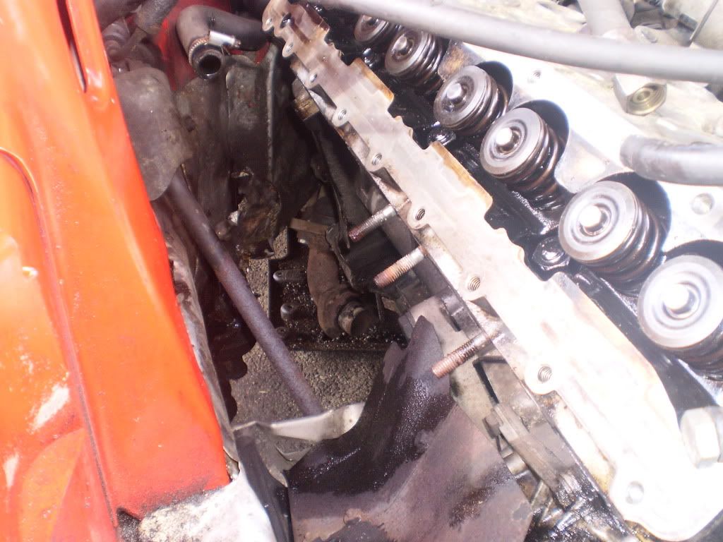

Exhaust headers off.
Cylinder head finally gives in lol.
The worst head gasket in the world by far!!!
The trouble is I am now in two minds as to wether this engine needs rings or not. The HG is pretty disgusting and has obviously never been changed. It would certainly explain the cross contamination of the oil and there was evidence of boiling water on the crowns of 2 and 3 piston. I know the valve stem oil seals need doing explaining some more of the oil consumption. However would it explain the low compression on all cylinders that improved when oil was added? Also would it explain the low AFRs I have been seeing? These are the bits I am unsure about. Doing the rings and big end shells is a considerable increase in cost. However do I want to risk not doing it just to have to go through this whole process again? If anyone would like to share any experience or advice then it would be welcomed. Thanks guys
What is the wear lip on the bores like? I guess if you poured oil into the cylinders all it could really do is seal the rings better so you probably have some ring/bore/piston wear. How many miles is it on? What were the compression figures? Remember its a low compression engine anyway! My inclination would be that unless your going to do a FULL rebuild or the compression figures are awful you should just sort the cylinder head out and put it back together as is.
If oil down the bores helped raise the figuares by a fair bit, the rings need changed. The oil looks very black as well Rob so could be gummed rings as well. What oil have you been using in it? Don't use your stuff from work or you will bugger it as the bearings need zinc/ZDDP for lubrication. 20W/50 is too thick as well really for a turbo engine I think if that is what you are using. I also noticed your 2 centre inlet ports are oily or carbony as well, leaking valves or heavy crankcase breathing. Check your breather pipes are not blocked out of the oiler filler pot and make sure there are no splits in the right angle hose that comes out the top as these are very prone to coming loose or splitting. Give me a bell if oyu want a chat about it, you have my number.
