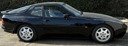

Helloooo,It’s on about 80k I think?
It’s not used every year and some years it does very few even when it’s on the road,but it runs really well,been to Europe in it a few times over the years for track days and to Cornwall.It had a full examination when it was put together,and a “new” big valve head ,I need a new cone filter at some point looks a bit old now but that can wait till next year,the black one is coming out Friday and I’m looking forward to that
What's the spec on the black turbo? Changing the subject I recently took my turbo out for the first time this year. It was running a bit low on boost, and after resetting it, I was surprised how well it goes now.
Pretty Standardish ,Promax Chip,Boost enhancer,intercooler upgrade,M030 suspension,968CSarbs,Castor mounts,strut brace,New Blaupunkt Bremen!First bought this in 93 ? ??
KW's plus the usual bits and pieces people fitted years ago. I bought a brand new LR 61-10 from Promax around 10 years ago, but I've never got around to fitting it. I don't use it enough, but that means it feels a bit special when I do.

I’ve got a set of forged wheels powder coated in black that would look amazing on the blue car!
Was the blue car a Turbo S originally, quick restoration then up in a fancy showroom for loads of money. Never raced or rally'd :D
Got a set of gloss black CS ,they do feel lighter,the black car is a bit of a nostalgia car ,bought it first time in early 20s,it came with the D90s…trying to relive youth now ??
