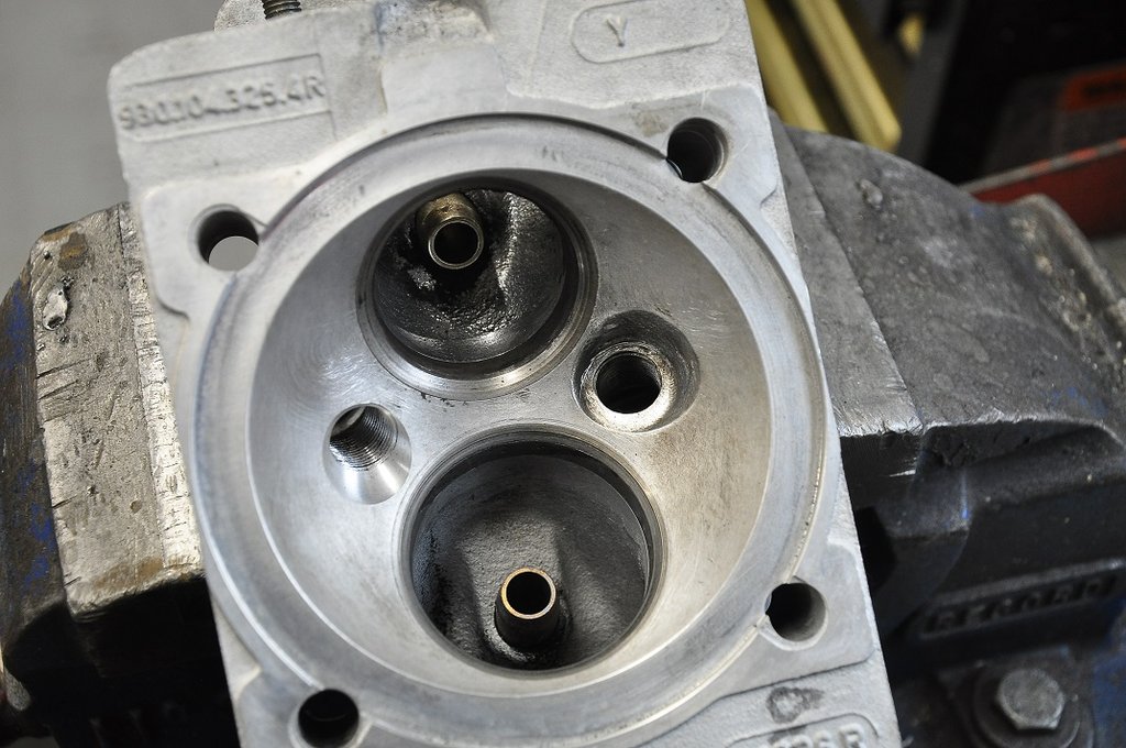

I’m intrigued to know how the second plug hole is machined into the head, presumably directly opposite the existing one via the diagonally opposite hole seen in the second pic? There must be a lot of material available, although at least there aren’t any coolant galleries to worry about. A very skilful job all the same.
Jeff
The second drilling is a well known mod going way way back into the 70s at least.
it is required to get a spark and hence flame front either side of the high crown Pistons.
There are YouTube vids galore but you need to take great care or you will break off some cooling fins.
the chamber has to be machined from both sides to open the plug electrode to the chamber.
Many have jigs for this repetitive job so once set up the machining is almost boring!
sharp tools and great care required.
and about £700.

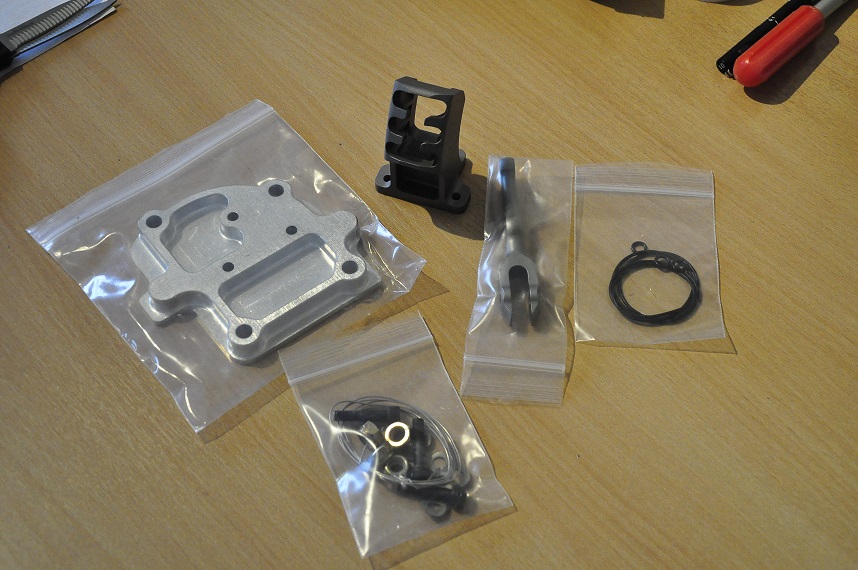

WEVO gateshift actually arrived, an expensive small box of natty bits.

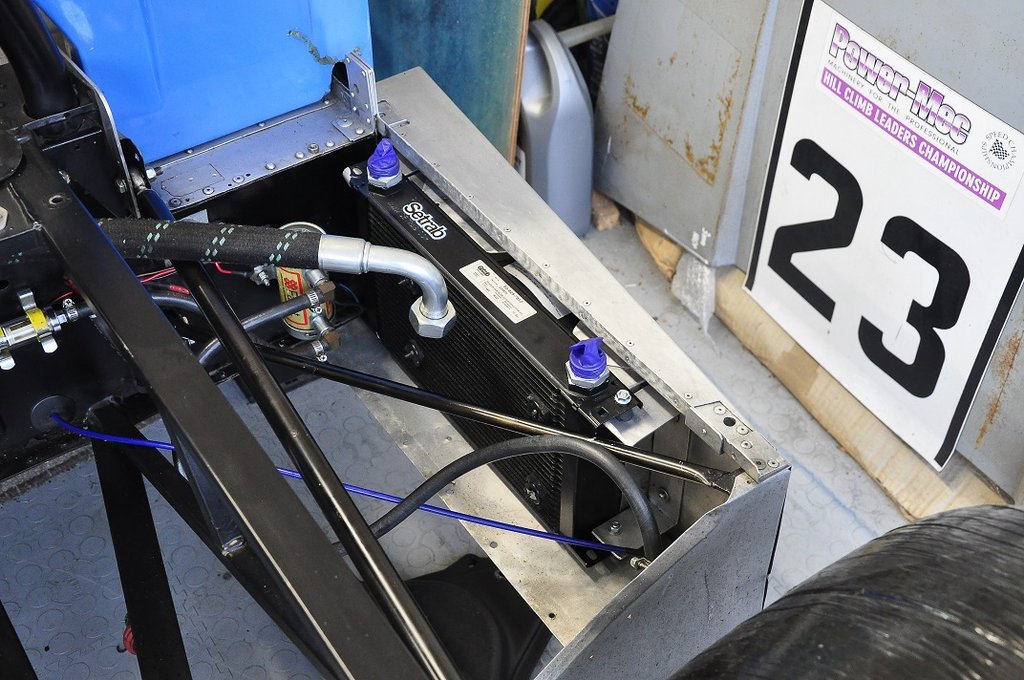

Had a busy day in the gaage. with no engine parts in sight I turned to the oil system and removed and cleaned the cooler and the huge dry sump tank.
Car was very dirty when they were removed, but everything good now.
It was with some trepidation I split the dry sump tank to see what was in the bottom after 5 years use. Swarf, bits of steel, shards of aluminium?
Nope, clean as a whistle, so chuffed.
This was a very good engine!
Dirty:
Dry sump apart:
Together again:
Cooler, cleaned and back in. So much dirt trapped in the cooling fins!

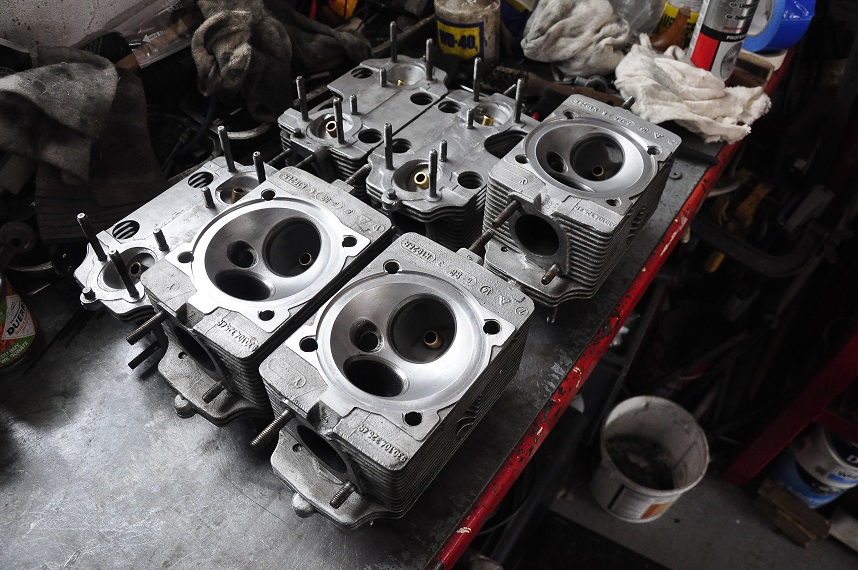

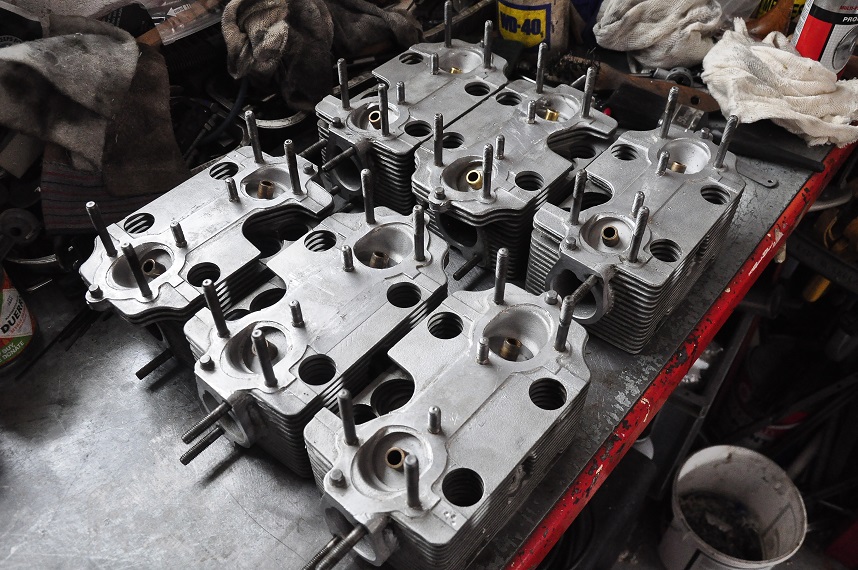

Got my heads back from The Head Shop in Warrington who have machined them for twin plugs.
Great to deal with, promised 3 weeks and a good price, ready by 3 weeks at the same price, no surprises, price quoted inc VAT, what a refreshing change.
Bought a nice new valve lapping stick with supple rubber cups so grip these huge valves, and after clearing the carbon from the exhaust ports and re-fitting some studs (removed to access the area for machining) finally ground the valves on one head, set the small temporary springs to hold the valves tight and all fitted to the heads with shim-less assembly but the titanium top caps to measure the height for the racing springs.
This method works a treat, no fancy £110 tools, just 2 simple springs, £2.00 each.
With the tension on the two valves, 2 plugs in tight, inverted the head and filled the combustion chamber with white spirit to wait for leaks. One drop came free after 35 mins when a fellwe DDK'r arrived!
Drained the spirit off and measured the distance from the underside of the top cup and the lower spring seat.
For the springs I need close to 36mm on both valves, so by adding the right number of shims managed to get to 35.8 and 36.2mm. Can't get closer as the shims are in 0.5mm thickness only.
Springs in tomorrow and that will be one head done, 5 to go.
