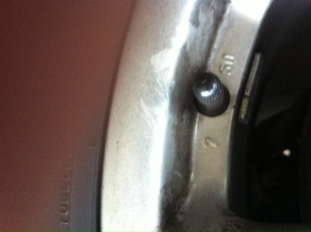

my wheel sizes are 7.5 front and 9.55 rears.
This is the front wheel...
Pictures are fine - you have 7" and 9" rims, the other number is the offset in mm (how far the mounting is from the centreline of the wheel).
Standard width rims for late Turbo, possibly optional on S2s,
Not quite: - standard width for a late Turbo is 7.5x16" ET65 at the front / 9x16" ET52.3 rear, on D90s.
