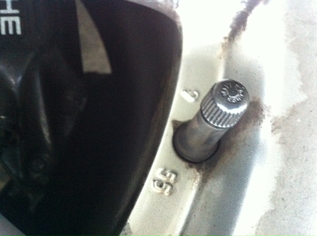

my wheel sizes are 7.5 front and 9.55 rears.
This is the front wheel...
ORIGINAL: A9XXC
Pictures are fine - you have 7" and 9" rims, the other number is the offset in mm (how far the mounting is from the centreline of the wheel).
Standard width rims for late Turbo, possibly optional on S2s,
