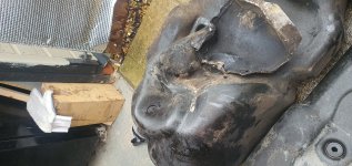

Bought the car like it, looks like the previous owner must have hit or ground out the car, and pushed the gearbox into the tank, the fuel sender was also bent, hence why my tank was never reading properly. Now just to put the gearbox back in!!!
Another possibilty is a vapour lock but not heard of it happening to a 944, other cars yes.. blocked vent causes a vacuum and air pressure does the rest..?
Pete
Yes I had vapour lock on a MK 1V Cortina (not my choice.. company car). Hadn't a clue why the car stopped as the gauge was reading half full. The car was about 6 months old.. hadn't changed the filler cap or anything..
