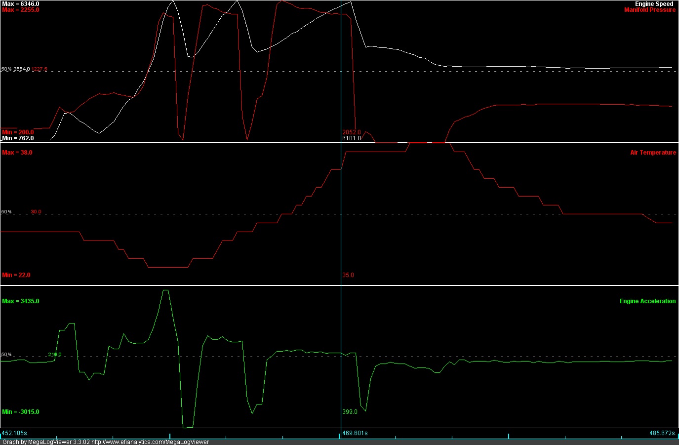

Thanks guys. Didn't do any back pressure measurement right now, just exhaust gas temperature. I went out tonight and did some ignition mapping, added a couple of degrees on. What a difference, damn. She holds about 1 bar at 6000rpm.
Bit over my head Tom, but looks like 17 seconds of data covering 1st gear then under hard acceleration 2nd, 3rd, 4th gears. For the first 8 seconds the intake temp drops from about 28deg C to 22, and then rises to 38deg over the following 8 seconds. Then over the following period it drops back quite rapidly.
When you say added a couple of degrees on, is that advance added?

ORIGINAL: George Elliott
Before the throttle is being opened "wide enough" inlet air was not flowing fast enough to avoid heat soak from the intake manifold, and temperature increased to 28°C.
Then the throttle is opened "wide enough", which increases the speed of inlet air, and the incoming air is fresher, until...
... the compressor spins fast enough to build boost.
Hot compressed air goes back into the turbo inlet through the recirculating valve as the throttle is being closed.
Tom, what was ambiant temperature during this run?
