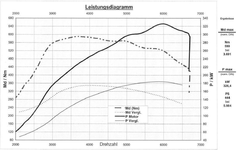

You may have seen it already, here is the dyno sheet from a friend's 3.0 engine with the Lindsey intake.
When a standard 968 turbo S makes a remarkable 368 lbs.ft (500 N.m) at 3000 rpm with the 951 intake, he sees that even earlier at 2700 rpm and it spreads up until 6100 rpm. Apart from another friend's 1200 bhp muscle car, this is the fastest car I have ever been in. Mine is no slouch but his is borderline insane.

Tom, his 3.0 engine is internally pretty much the same as mine, except it runs a K26/8 turbo modified with modern 3K-BW compressor and turbine wheels, a full 3" exhaust with cat, a custom twin intercooler, and the standard Bosch Motronic modified to run a MAP sensor instead of the AFM. It was all done by http://www.etg-technik.de/. I met this guy again this Summer during a barbecue with 4 other 3.0T guys, does very good work. I first saw his modified Motronic 5 or 6 years ago. He makes turbos, exhaust and stuff.
Patrick, my friend Marcus with this engine said he moved to the Lindsey intake as the standard one prevented him from breaking the 380 hp barrier. I think your intake guy is right on the money - most factory intakes are designed to make turbocharged engines easy to drive on the road to the average driver. And at the risk of repeating myself, reusing on a 3.0 engine the exact same intake as on a 2.5 engine says it all, in my opinion, especially on a turbocharged engine.

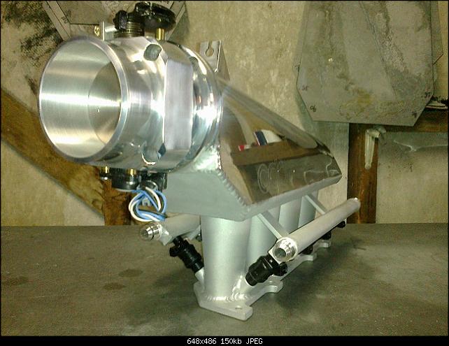

This is the Facebook page of the local Intake guy I was going to use. I spoke to him a few times and I believe he could have made something that would have been an effective improvement over the stock version. http://www.facebook.com/customplenumcreations

What boost is he running on that dyno chart above?
It is interesting to see that he is getting just under 430hp and pretty much a perfect torque curve with such a wide power band. It looks like the only significant difference (compared to our engines) in his setup is the intake. It does make sense though that if the standard intake has some imbalance and the Lindsey intake flows as evenly as they claim (flow balanced and tested), that indeed there would be some power coming from optimising the flow to all cylinders. It also follows that with all cylinders working evenly that boost would come on sooner resulting in faster spool as well resulting in a wider power band.

George, MAP not MAF with a modifed Motronic to make the MAP sensor work. Other than that it looks to be a fairly standard 3.0 8v similar to mine and Thoms as you detail above. Mine has a (supposedly) more performance oriented cam, but I am yet to be convinced it makes much difference, especially looking at the power curve above!
Thom, do you know at what psi and also is that to the crank or wheels?
Edit: just saw this is a k26/8. Would have to be at the crank at the very max modified or not.
Yes, these are figures at the crank, with 1.2 bar of boost.
I don't have a curve showing boost against RPM but I suppose he's running a copious amount of ignition advance to get that much torque so early, considering that the shorter runners of the Lindsey intake should shift the torque band to upper RPM for the same ignition settings. His turbo is as quiet as a std turbo and the exhaust note not particularly intrusive. The larger engine size gives it a deep bass note but it all feels pretty much like an electric car, with a huge torque kick very early that seems to last forever. He mentioned a peak exhaust back pressure of 2 bar, so I think his turbo may be sized perfectly to spool as soon as possible yet breath still decently in upper RPM, again with the suited ignition mapping. The compressor should flow much more than a K26, as I said this KKK-based turbo is using modern KKK-BW internals.
He did mention to me that he may like to try a slightly larger compressor so that the engine becomes a bit more lively and "fun" up top, at the cost of losing a bit low down torque and being slightly less efficient overall, but that's not a priority at the moment.
Nick, I think you would break the 450 bhp without too much effort with a Lindsey intake, thanks to your JME camshaft and to the SPS compressor that I think should flow more than this KKK exotic.

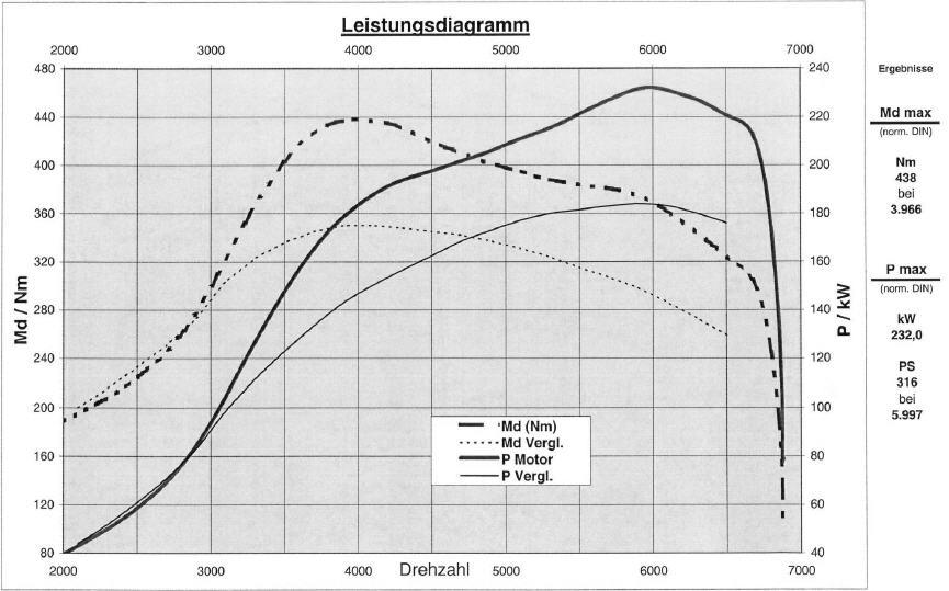

To put the dyno sheet above into perspective, here is another one from a standard 2.5 turbo engine fitted with another one of these special KKK turbos, here with a modified #6 turbine housing. These figures are about in line with what we are used to hear from mildly modified 2.5 engines, aren't they?
