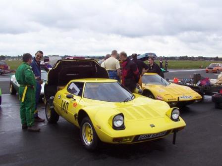

I find my S2 the most forgiving of cars,
now ask me how many times I spun this at the sprint
