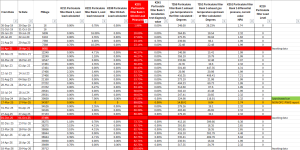

Ive just had a thought, surley if these cars required a modified OPF to fix this issue as explained in the memo, WHY weren't all the affected cars called back in that were sold before December 2019.
It would have been an easy check for the Dealers to carry out, the first service would be a good time to have a look..
And if the Ash% level was to high, the modified filter could have been fitted under the manufacturer's Warranty.
The reason I say this is, we have an owner with a vehicle that had a reading of over 75% at his first service, at 11,713 miles.
Whats Interesting is on the same day another reading was taken showing an exhaust temperature of 620.60 degrees centigrade.
Which could be a possible regeneration attempt to reset the ash value.
This unfortunately didn't make any difference to that Ash reading of 75.69%.
If this was the case, then this GPF should have been replaced under the manufacturer's warranty, unfortunately it wasn't and the customer was never informed of this situation on his car.
So his warning light came on, with a P242F code 100% Ash recorded, and quess what, its not covered under warranty and he as to pay.
This customer bought this car from new, we have been asking Porsche to sort this issue out for a very long time.
And we are still waiting, you will see that later in the cars service history he didn't use the Dealer, they are saying because of this he has to pay, something to do with spark plugs, which are required every 4 years, or 40K.
Why should he pay for a manufacturing defect on his car that was present on the 1st year service.
The Dealer and Porsche should be ashamed of themselves for treating this customer in this way.
We managed to get this GPF information, but its been a real battle, but thankfully it was worth it.

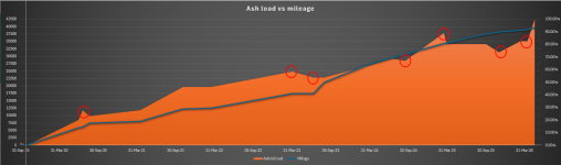

Hi everybody
I thought it was time to list our GPF fault working progress at the moment.
1. From last year we are still trying get the Dealer and Porsche to authorise replacing the GPF that they have said is faulty. This is the car that had a 75% ash reading when it went for its first Dealer service at 11,713 miles in 2021.
2. We have three 718 cars that had new modified filters fitted last year, which are having regular ash % level checks. We managed to convince Porsche and their Dealers that the GPF data they provided didn't make any sense at all, and they where fitted F.O.C.
All these cars have now ash percentage levels that are far to high, bearing in mind the time since replacement, and the mileage covered. Two have around 50%, and the other one was at over 70% the last time we checked.
On average our cars have taken 6 years to hit this 100% oil ash measured value, some of these cars have left the workshop with over 50 % of ash already in the software after the new modified filter was fitted.
3. We have two more 718 cars that recently had the 100% oil ash load with the warning light on.
We are currently waiting for news on what the Dealer and Porsche are going to do.
4. We have another 5 cars out there that are running around with the warning light coming on and off, one of them is a 2021 car.
5. We also have a 2019 991 with both filters showing the 100% oil ash reading, and again we are waiting for news from the Dealer, we have asked for the GPF data.
Has you know we are asking for back pressure checks to be carried out once we have the diagnosis from the Dealers that the GPF has to be replaced because its full of ash.
Over three years in and we have been refused every time we asked this question.

Hi Guys & Girls
Just another update regarding the way the Dealers are trying to reset these ash values, they have continued to try and re set the ASH value by carrying out a soot regeneration, when no soot is present according to the PWIS data.
If you look at the data below, you will see that when this vehicle went in for its first service on the 24/6/2021, the PWIS diagnostic tool recorded this information at 12.29pm.
You will see that no soot was recorded, and the ASH value was already at 75.69%.
The exhaust temperature T255 was reading 317.35 degrees centigrade, and the differential pressure sensor K251 was reading a minus pressure ?.
You will then see at 15.41pm, another PWIS check was carried out, but this time, a regeneration was carried out because the exhaust temperature T255 hit 620.60 degrees centigrade.
If you look, no soot value was again recorded, which could have been down to the soot regeneration, but who knows because we never see any substantial soot readings ever on these cars.
The reason why the temperatures recorded in T251 don't mirror the T255 reading is because the engine wasn't running, just ignition on, when the engine is running the algorithm brings in the other temperature reading.
You can see this on the next visit 23/2/2022 at a mileage of 16,0750 miles, more data recorded, the vehicle had covered 4,337 miles since the regeneration attempt.
The ASH reading was slightly higher 76.08%, but look at the differential pressure sensor readings K251, can you see a pattern forming, same reading on the PDI check, which you would expect, but the same reading when the ash value is at 76.08%.
Doesn't make any sense at all, yet the Dealers and Porsche choose not to see this data recorded as being relevant to whether the GPF filter is actually full of ASH.
On the diagnostic visit with an ASH value of 100%, and the warning light on, and the DTC P242F code present, the sensor reading is only 0.17 hPa, impossible.
The internal memo that came out last year, says carry out a regeneration and if the ASH level does not re-set, fit the new modified filter, that was brought out in late 2019 to fix this ASH issue.
Sorry for repeating myself again, but this is important for you to see what we see, when we challenge Porsche and their Dealers.
We have always said the GPF isn't blocked with ASH, and a simple back pressure check would confirm this.
It only takes just over an hour to replace the differential pressure sensor, all we need to do is disconnect the GPF supply pipe to the sensor and fit a manometer into the pipe and check the actual GPF pressure.
Dave

Morning Dave, as you know my ash level has dropped back down to 76.08% with no intervention as yet. EML light has gone off but fault still present in diagnostic check. Maybe just coincidence but it’s the same figure quoted above ? physically I don’t believe its possible for oil ash content to reduce by itself and it will be interesting to see what the dealer says on the 30th when they follow the memo to fault find?‍♂️ keep up the great work m8

Hi Tony,
Thanks for spotting the ash value 76.08% across both of these vehicles GPF data, if we could get more GPF data reports showing multiple visits to our Dealers I'm sure we could find more reoccurring information.
Its often said its all in the detail, so Ive compared your data to the other cars data with both showing the same ash value above.
Your car The other car
K211 soot 0.00 0.00
K221 soot 1.96 5.88
K230 ash cal 0.00 0.00
K231 ash measured 76.08 76.08
K241 diagnosis val 0.00 0.00
T255 exhaust temp 512.48 373.79
T251 exhaust temp 488.85 360.04
K251 diff pressure 6.22 0.00
So if you look back at our other cars differential pressure readings from the PDI you can see reoccurring hPa readings.
Differential Pressure hPa
PDI 2.90 Ash load 0.00%
Wheel repair -0.58 74.12%
1st service -0.58 75.69%
Regeneration 0.00 75.69%
Mot 0.00 76.08%
Diagnostic 0.17 100.00%
This car also had a soot measured K221 value of 21.57% when the car had covered only 14 miles, before he took delivery of his new car.
And also it had the DTC code P0234 present on quite a few visits.
This code is a turbocharger overboost code, this is well known on these cars, usually down to a seizing actuator linkage pin.
There has been a bulletin out on this issue for quite a while.
When you look at the internal memo that was sent out last March it mentions several causes of high ash loads that have been found across various vehicles.
It said it was important to check the operation of the turbocharger actuator to ensure it was functioning correctly.
So when this car went in for the diagnosis of the warning light on, and the fault code P242F ( ash load to high) why wasn't this detail looked at more closely.
Why wasn't the checks on the memo carried out before the customer was contacted.
He was told the GPF had to be replaced, at a cost of £9,300.00 and any other diagnosis time would be charged to him.
He has asked several times for a back pressure diagnostic check to carried out, and he would pay for it, but this has been refused every time.
They have the PWIS data that shows this fault was on the car at the first service, and they even carried out a regeneration to try and reset the ash %, it didn't work as you can see.
And the worse thing is, the customer wasn't told about the regeneration attempt, the high ash value, and was never aware of the turbocharger issue either.
We are over 5 months in with this car, trying to get the Dealer to do the correct diagnosis of this fault, even though they have an internal memo that confirms that this is a manufacturing defect, and has been for a very long time.
Remember the memo says the new GPF (982254400AF) has been modified to prevent this issue. All vehicles with a production date later than December 2019 should already have the modified GPF fitted.
So they would know which cars didn't have the modified filter fitted durring the first year of production up to December 2019.
Their warranty data would show the modified replacements, so all these other cars should have had the new modified filter fitted.
We have been slowly dealing with these other cars, its taken us over three years, but sadly we couldn't deal with them all.
Whats even more appalling is that most of the owners who contacted us that required new filters have sold their cars, because they were blamed for this fault, wrong engine oil and driving style.
This is absolutely bloody ridiculous that these Dealer's and Porsche are not telling the truth about this well known fault on this car, its scandalous, and it has to stop.
Dave
