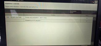

To continue on with our challenge to Porsche Technical for them to confirm to us that our cars have a manual adaptation facility on PWIS that would re set the oil ash reading to zero.
Found this VCDS (VW) video on YouTube that shows how easy it could be, its on a DPF, but its the same on a GPF car.
This is what we would expect to see on our cars, or something very similar.
Both DPF and GPF vehicles have to have an adaptation capability in order to reset the ECU, when either the filters or the differential pressure sensors are replaced in service.
