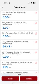

He has found and purchased a reasonable priced diagnostic tool that can read your oil ash % levels.
Enclose his detailed post for your attention.
I received a £70 ThinkDIag OBD2 scanner yesterday and can confirm that this device will show the GPF ash load etc data on a 718. Device was tested on a MY2022 base 718 2L Cayman.
The menu system on this reader is somewhat obscure. The route to read the GPF data is as follows:
Connect to the ThinkDiag dongle and select 'All Systems Diagnostic'. Let the app connect to the dongle, search for the VIN, confirm the car make/model etc and then:
System Selection
DME (Engine Electronics)
Read Data Stream
K_Catalytic converter
check boxes for the following:
K210_Particulate filter, bank 1 - loading level
K211_Particulate filter, bank 1 - soot load calculated
K221_Particulate filter, bank 1 - soot load measured
K230_Particulate filter, bank 1 - oil ash load calculated
K231_Particulate filter, bank 1 - oil ash load measured
This will return readings for the above. You can then save the readings in a pdf report within the ThinkDiag app.
I had a quick look around the menus to see if this value could be reset via the ThinkDiag. I couldn't see any obvious route to this; however I did note that in the 'Special Functions' section of the DME module there is a menu option to initiate a GPF re-generation. I didnt try this.
At least this way owners can monitor their own K231 ash load values over time rather than having to rely on OPCs to (maybe) give them the data, and at cost.

I have enclosed a copy of a typical GPF report, page 42, for you to see what we see.
The differential pressure sensor reading is K251, and the oil ash measured load % is K231 this puts your light on and causes all this trouble.

Well, some more good news, just had some feedback from one of our members, he's just purchased the Thinkdiag diagnostic tester I mentioned on a previous post.
He's delighted with the information it provides, it shows all the information he needs to check his oil ash % level, soot readings, and the differential pressure sensor information.
Enclose below the information provided by this diagnostic tool.

We are still waiting for some more data to come in from the vehicles that are out there with new filters fitted, to get more information regarding this issue.
When we have collected enough data on these faulty vehicles we can then see if this constitutes to a possible GPF control defect, and then possibly take the necessary action.
Dave

Regarding your question Ian, concerning the tail pipe emissions on these cars, if you look very closely the light grey deposits have a very slight brownie tinge, which is from from the ash.
Suggesting that the GPF is functioning correctly, which means that passive regeneration on these cars seems to be working ok.
In the last 2 years, looking at all the data from all our cars, we have never seen a soot regeneration warning light and message come on the dashboards, which would instruct the driver to help with an active regeneration process.
This soot regeneration process leaves 2 specific DTC codes as follows
P2463 Particulate filter-soot load high
26740 Particulate filter-regeneration needed
Along with these codes you would see soot values in the calculated K211, and the measured K221 in the region of 50%.
We have this important data on record, it came about after one of our cars had its GPF cleaned with a diesel cleaner that contaminated the filter and set these DTC codes.
Eventually after several road testing outings, using the deacceleration instructions from the drivers handbook, and lots of attempts trying to clear these codes, the codes finally cleared.
And you are right, we should not be worried about our GPF filters blocking up, on vehicles with such low mileages covered.
Regards to your question, hillclimber,
For the last 2 years working with the owners of these faulty cars, it became very obvious very quickly that the low pressure readings from the differential pressure sensors didn't make any sense at all.
On receipt of page 42, the GPF data, a pattern was forming, they all had no back pressure.
The Dealers where insisting these filters were blocked and had to be replaced, so we asked them to look again and contact Porsche Technical for advice, after lots of pushing and shoving, they conceded and have covered the cost to replace these filters F.O.C on every car that was presented to us.
We have gone from this process taking months to get authorisation, to now a matter of weeks.
I think what's significant now, is the new information that was sent to the Dealers in March this year which confirms that Porsche have seen this issue before. It concerns what happens when this DTC P242F, is seen on the dashboard, and the work instructions and checks that have to be carried out, before a new modified GPF is fitted.
We have more information on this document to follow.
