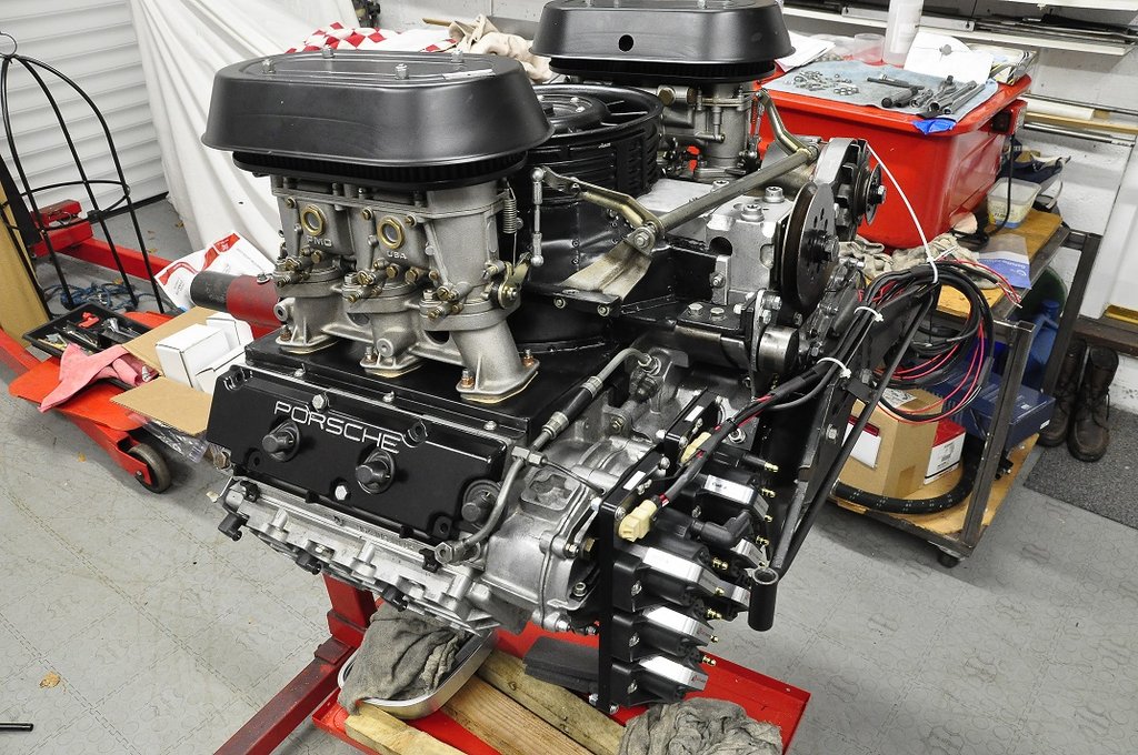

Coming along nicely Graham. Some neat electrical work there … looks very professional! I presume that the only way to check it out properly is to actually run the engine when it’s installed in the chassis?
Jeff
Afraid so Jeff.
I hope to pre-set the Clewett timing advance for a safe start position and get it running on all '12', for it to rev, have oil pressure and hold it's temperature at home.
This should be in the next 10 days.
If that all goes to plan, the car will go to the BHP rolling road for the timing to be set as close to optimum as possible.
Fortunately, there is a lot of data to what the values could be, so safe and quick to get very close.
Can check on the rollers for usual figures and at what revs.
That will be a nerve wracking day for sure.
No running in, no nice smoothing of the rings and bearing, just harry-flatters from the start!
What can possibly go wrong?

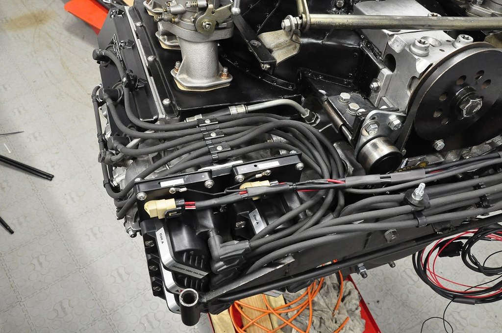

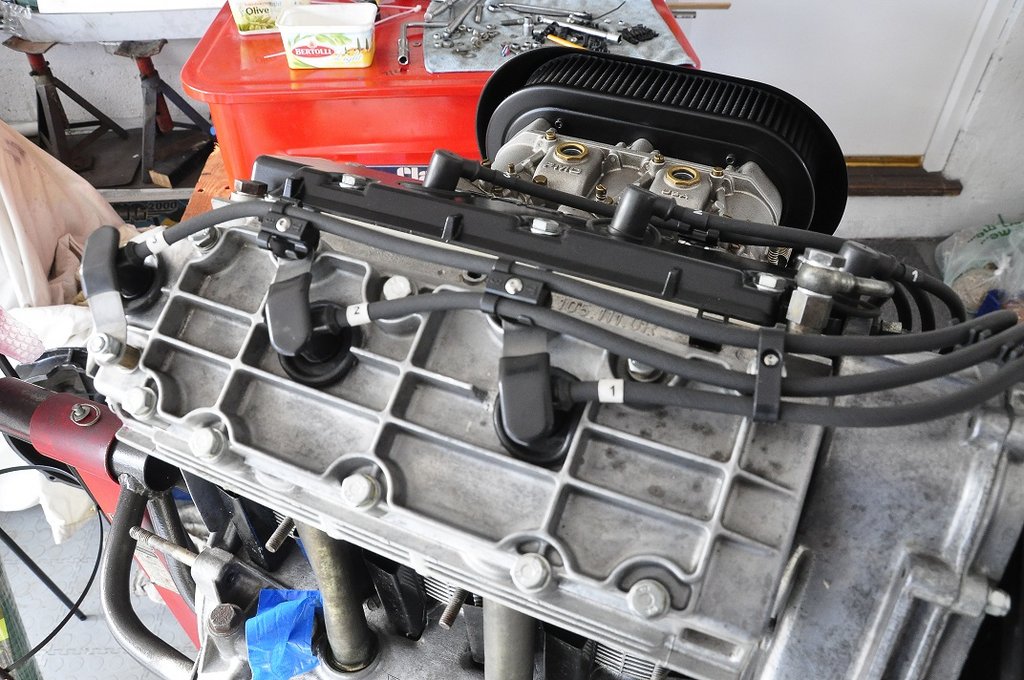

Bet everyone is almost as sick of this engine wiring as I am.
BUT, now done, or at least the spark lead side is. Gave up trying to stop 12 leads from touching each other. I'm working on the 'dream' that with everything being new the spark will want to jump the plug and not to the engine. Time will tell.
First, bought a £37 crimping tool off ebay. It is utterly fantastic, and worth every penny. Could not do all this without it. The £4 green plastic crimping tool is best left as 'Not fit for Purpose'
Guessed the lead lengths I needed at 15 meters, and ended up with 2 meters over, could come in handy.
Lots and lots of hours have gone into this whole sparky affair and we are not done yet!
Plug clips to be done on the lower covers tomorrow, cam lube on the lobs and fit the covers for the last time. They didn't leak before, but crossing my fingers for this time.
I can then fit the ex manifolds and prep things for fitting the engine into the chassis before finishing off where to mount the control unit which might be trickier than it sounds.
A lot of wires there Graham … looks a bit like a W12! ??
Impressive crimping tool. You wouldn’t want to get your fingers too close to those jaws!
Are you planning to mount the control unit on the engine or on the chassis? Either way I guess that the vibration levels will be high, although I suppose that the unit is sufficiently robust for it not to be a problem having been developed for racing?
Jeff
Inside Jeff, as inside as you can get in an open race car that is...
Unit is solid state and quite weather tight, but hope to shroud it in some way so excess rain will drain away.
Some car manufacturers seem to fit an extra insulating sleeve over plug cables where they can't avoid them touching each other or parts of the engine-OE leads on 924S's have them.
Indeed, I've been tidying-up some of the snakes nest by the coils today, and have untangled some to smooth the passage out, but many are touching.
I still think the parts are all new, so I expect the volts to get to the plugs rather than to the engine.
Time will tell.
This is a very tight installation. If I have to re-do the lot it is a pain but not a disaster.
