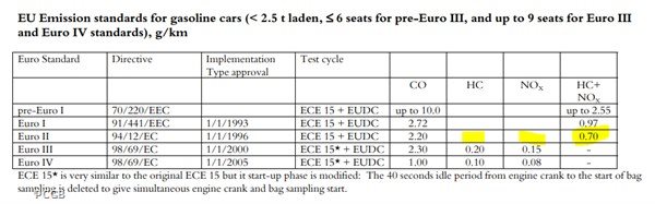

https://uk-air.defra.gov.uk/assets/documents/reports/cat15/0408171318_SIPhase1reportAppendix1Issue3.pdf
Car - Euro II standard were specified in directive 94/12/EC for passenger cars.
Note that requirement is HC + NOx test, not separately
Difference introduced for the Euro III "...values of 98/69/EC is that the quantities of NOX and HC are specified separately, rather than there being a limit for their sum as was the case for earlier standards."

Now let's look at the 993.
Note: Euro II standard were specified in directive 94/12/EC for passenger cars
Testverfahren = "test procedure" and there's no such thing as III 94/12EC
And here we see a Euro II test result (incorrectly) transcribed into Euro III form, or perhaps an early-adopter III result also transcribed incorrectly. HC + NOx again put into the NOx field.
(like was done for the early 996 certificate above)
Assuming Porsche made the same error that means the true NOx emission is 0.178 - 0.112 = 0.066 g/km.
Much closer to the 996, more reasonable and to be expected given capacity and , and compliant with ULEZ
This correctly reduced figure is to be expected for a car with a catalytic converter fitted
