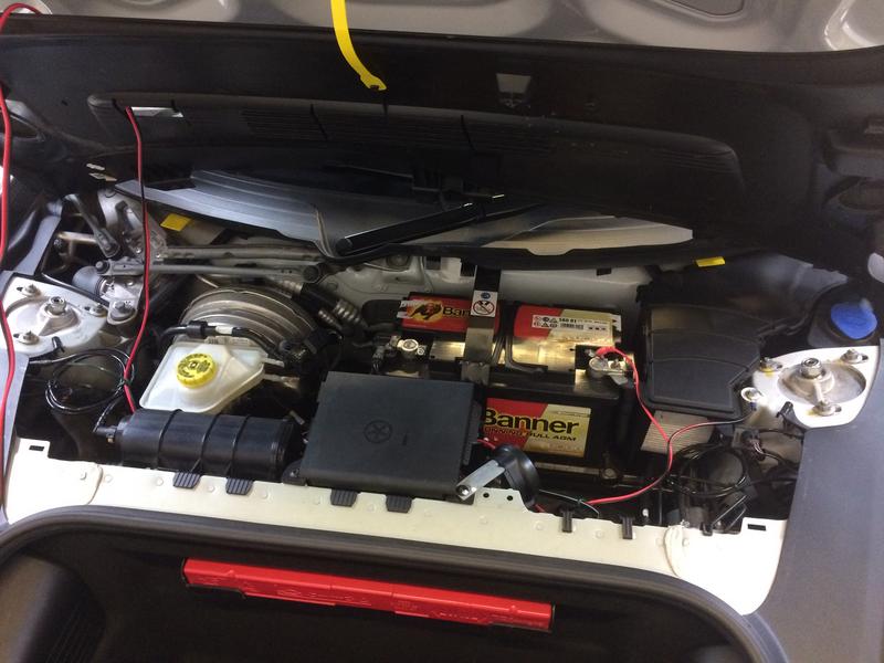

As Ralph states. Both he and I have hard wired ours to: Positive post and the negative to the top of the suspension tower.
To Niel,
I dont think I removed the connections to the battery. If memory serves me correctly: Positive first, beware of negative lead flapping around, secondly connect to suspension. It's been and age since I did this but I think you will need a bolt to fasten the neg terminal to the strut top. You will need to check the thread diameter on the strut mount (6mm or 8mm??). The strut top mount has been tapped out already.
