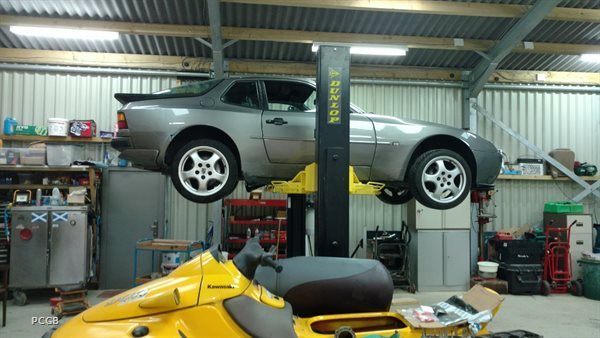

Lift is Dunlop DL240 single phase which I got from Gemco but got local courier from where I stay to go get it. Delighted with it so far and the new garage
Looks like an excellent man cave. I have a pit in the garage at home but was thinking about a lift in my unit for those jobs where the wheels are off. I oscillate between a new and a used one, guess it depends how many pennies are available when I get around to it!diabloam said:Always wanted big garage and 2 post since I was a nipper and finally got it all sorted, although I did have to redo a new copncrete pad for the floor for lift. Company would not warranty it unless it was fitted as per there guidelines and fitting istructions, but they let me assemble it myself otherwise (easier than I thought it would be), although kango and pick to dig deeper pit for pad was hard work.
