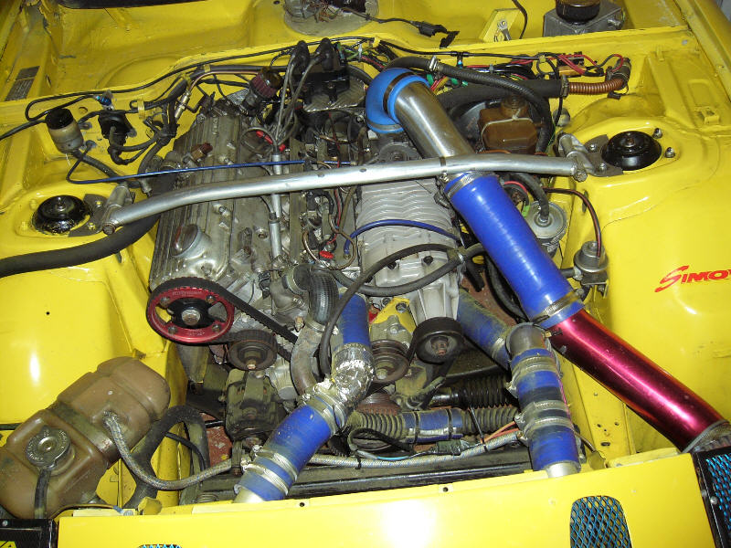

In my experience the centrifugal charger suits our cars perfectly, and retain great (in fact improved in my experience) driveability. I'd like to answer some of your points individually below:
-nothing at low revs -
hmm, at idle and below about 2k you're right, but boost builds quite quickly with revs and is doing really good things at 3k and over the power band any enthusiast is likely to want - between 4-6k - it's stonking.
- scary quick at high revs -
not sure the sub 300bhp I'm running is ever scary, but it is highly amusing in a light car, with overtakes being effortless. For the road I really don't think much more power to weight is required (not that it's going to stop me).
- think tuned 944 turbo but worse lag -
Total twaddle. Sorry, but it's unlike any turbo I've ever driven (noting that I've not driven a car with the very latest ball bearing turbos), there's instantaneous response available at any time, forget having to change down to overtake, it just goes. The power is consistent with rpm and the rush to the red line simply makes the car feel like a much faster tuned NA car, which is exactly what I want in a fun car.
So why not a roots? NA 944s of all variants (with the exception of the 944S of course) have great low down torque and the S2 and 968 are kings of this. The gearing/traction is such that it's arguable whether you really want any more low rev torque to keep it easy to drive on the road (and debatable as to whether the gearbox or engine will take well to it). A roots charger in my experience (on other cars, not a 944 - so I'm open minded) doesn't tend to give the feel of a true sports car, there's no 'on cam' type rush to the redline.
If you read my previous posts you will see I am not blinkered into thinking that this is the right choice for everyone, the cost alone to do the job properly will see to that, but I am having more fun than ever before. Of course if anyone ever wants to experience it and they're local they just have to pm me.
Good post Peter. I agree with what you say as the centrifugal SC is basically the best of both worlds i.e. a turbo power curve without the lag as the boost response is directly linked to your right foot. The key is in making the installation work. Boosting an NA car, 968 or 944 is no mean feat and takes a lot of time = R&D. The problem I always had with the SC kits offered by shops was that they did not put the R&D into the product and instead use the first few customers cars as test mules. You car seems to work very well according to what I have heard on the grapevine and the weight loss no doubt makes it even more special.
