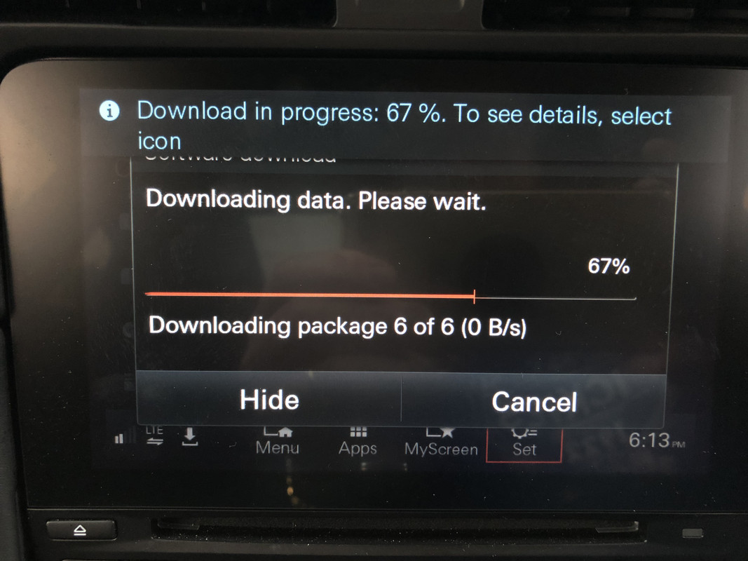

I got it to upload ..
but then my SIM card required (auto) top-up and download paused. When my SIM card gets to a minimum value it automatically charges my credit card but there is a 10 minute delay for request, credit card accepts charge, SIM card updated.
So I switched all off, turned ignition back on, found Nav update page and it restarted from the 67% point and I left it when it had got up to 80%. When I returned to the car some 45 mins later I got this.
It is parked in its garage. Decided to call it a day in the hope that it had fully loaded the maps so tomorrow I'll take it out round the block and park it in the garage - hopefully that will finish the map update.
Looks like Porsche AG have sorted their server issue. Make sure you have lots of data left on the car's SIM card. I'll see what tomorrow's parking experience brings..

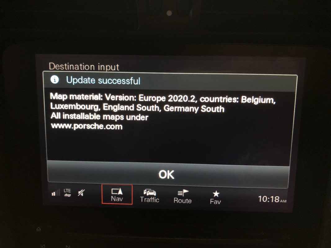

And this morning whilst in its garage, turned ignition on, the car had decided it was indeed parked and Nav screen showed this:
So there is some step to finish the update but I am not sure what it is other than ignition "on" / "off" on some basis. I wonder now whether I can update some more maps (beyond the apparent 3 per update limit), but I’ll leave that for next week’s experiment in the world of Porsche software.
Here's the odd thing, your displayed version is 2020.2 which I downloaded November (ish) last year. Have there been no updates this year?

Good to know, I wonder if it just downloads the next, not the latest version, - a bit stupid but with Porsche? The two updates a year does not mean the map database is updated twice annually, just that owners can run two update processes although... I did try to see if I could update any more maps but all save for the ones I had updated, were Greyed Out and not selectable. The updated ones were highlighted but not selectable.
