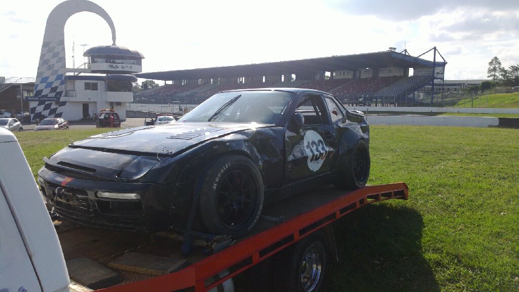

Nick, did you happen to weigh the stock door before you stripped it? I picked one up the other day and couldn't believe how heavy it was. Felt like about 25kgs? I got a set of c/f doors made up that I haven't used due to a couple of reasons, but they weigh around the 2kg mark with plastic windows attached! They're crazy light but as you mention, don't appear to offer much protection in the event of a crash. Having said that, I am glad I had my door bar in the stripped stock doors when I had my crash. Amazed to see just how strong those bars are and just how much impact they survived while also keeping the cage totally untouched inside. Made me think that if I continue to use the stock doors that I might just keep the door bars intact. Note what appears to be an imprint of the roll cage in the door is actually the bar.
im afraid i didnt get a chance to weigh the stock door, i just thought i would make it as light as possible! the impact bars are surprisingly strong like you say, but i am going to be extending the doorbars right out to the outer door skin so the impact bar will be next to useless and in the way. this way the doorbars are as far away from the occupants as possible, and give protection to the sills etc as the doorbars will be the first point of impact. obviously people running fg or cf doors will not be running the impact bars in the doors anyway, so the cage becomes the protection.
