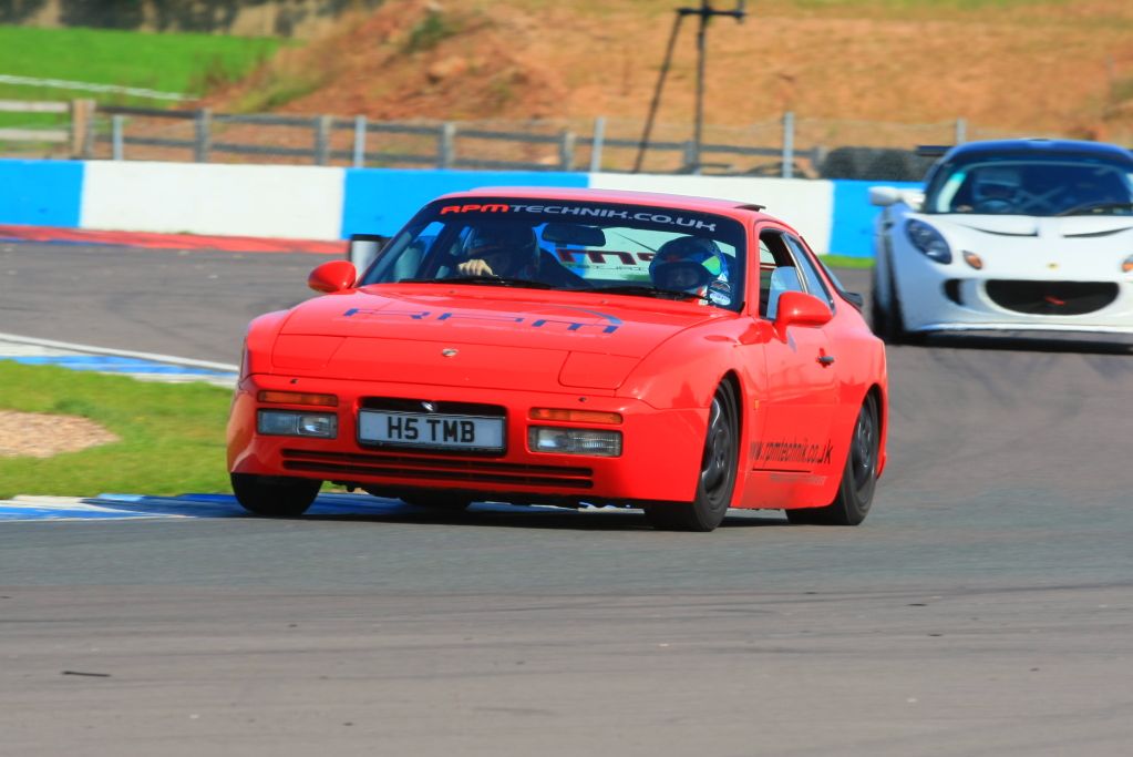

Awesome day at Donington park on Monday, the car performed fantastically. My friend had a session with an instructor and he was surprised at the level of grip this 944 has. Looking forward to the next one....
Great stuff Will - I think the 944 is well suited to Donington. ...but were you flat all the way from Redgate through Craner? [;)] TBH I tried that once on my last outing there & the back end just stepped out a bit mid-corner, which was a touch unnerving. A little lift just before felt a bit more secure. I'm sure I was quicker through Craner in the S2 than I had been in my turbo - my only problem was getting the car slowed and in the right place for old hairpin [:)] I am going to explore damper settings to see if I can reduce the tendency for mid-corner oversteer in very fast bends. (may be roll oversteer I suppose as it's only running standard arb's)

Learnt a lot about the 944 at Donington (my first time there) my lines were poor in the am session but after some instruction we nailed it through craner, trying a combination of short shifting to 4th at the top and going flat out in third. Excellent track but will do it next time without the Melbourne loop. My mate hate one excursion on to the grass but his last sessions in the car were really quick!
craner is definitely a 4th gear corner for my S2....although of course it depends on getting a good exit from redgate.. I only use 3 and 4 on a lap here, apart from a quick burst in 5th on the back straight. I feel like I ought to be able to go through old hairpin & coppice in 4th as well, but I can't quite carry enough speed ( more practice needed) I end up changing up to 4th during the exit of coppice as I'm on the limiter in 3rd. of course your car may be a bit different if it has the turbo box. best thing would be a chance to follow someone like markk's lines as I know he's quick at donington. (fastest of 1.21 in his old 944 race car I think - I wonder how the 968 compares.)
