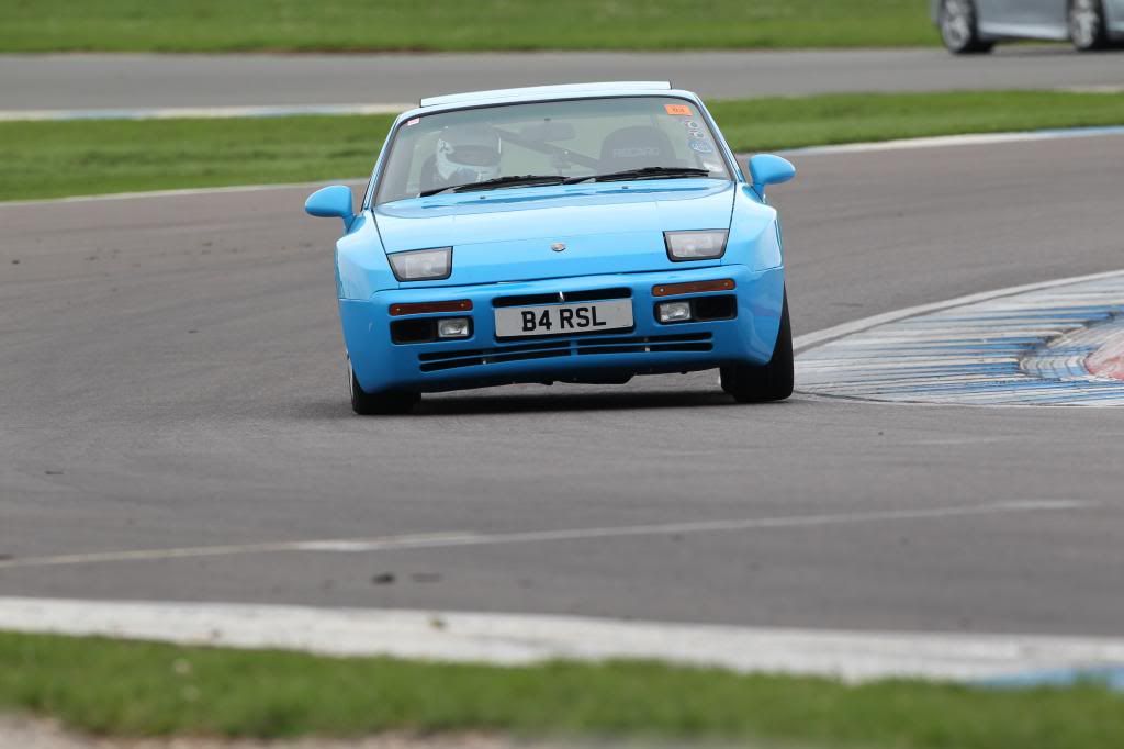

OK. Feedback time.
EMC fitted a new fibreglass turbo-esque front bumper, ducted air into the intercooler and ducted around the radiator. They removed the cone filter and replaced with a standard turbo air box. the bonnet scoop and badge panel vents are also gone.
The result... full power all day long at Donington. Job sorted. Thanks to all for pointing to this solution.
At the same time I had Gaz Gold dampers fitted and M030 anti roll bars. These proved to be excellent on the track giving good control of the car with the characteristic towards slight understeer. On road they are choppy i.e. you feel every undulation. By no means undriveable and for my use (getting to and fro to tracks) perfectly acceptable but I would not put these on a daily driver. Pic below is me leaning on the suspension hard at the chicane at Donington.
again, thanks to all for the help and guidance. Re-mapping next then hopefully that's it for now!
Mick
That's excellent - looking good now.... Good to see that the forum works
I bet the car drove so much better on some stiffer springs [:D]

That's a great result Mike, and even better in the high ambient temperatures we've been having lately compared with that dank day at Bedford.
The blue meanie rides again [:D]
