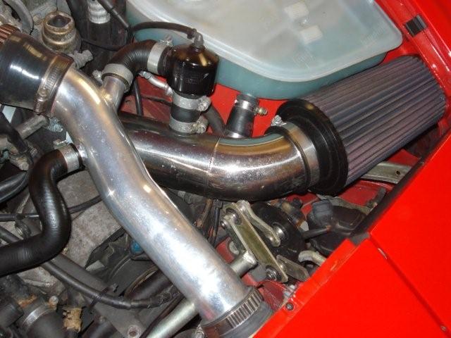

Hard Pipe To Intercooler Hoses

This hose blowing off thing that seems to be happening to people would be totally cured with those clip/clamps i keep going on about!!!!They really work and then you can boost with confidence...!Promax got me mine,only one needed each side of the connections to the intercooler....If you are running big boost and actually spank your car you need these clips!!!
I don't understand the fuss with these hoses... been running 16psi with all the original hardware after the turbo and no hose has blown yet, even with a dual BB SPS turbo that does blow an awful lot more air than a standard K26.
Reason we went for the special clips we found at higher boost levels the standard clips could every now and then blow off,my other car that runs similar boost to yours nearly at 1.1 bar(16psi?) boost the standard clips are totally fine,the red car is running at 1.5 bar at max, hence the need for the teeth type,no blow off now.
Thom these cars are talking boost pressures of about 20psi and over [8D]
At our weedy boost levels on 3L cars we could hold our pipes on with blu tack [;)], I dread to think what would happen at higher boost levels [:eek:]

I've blown a hose off twice in 4 years - both times because I had the intake piping in bits & failed to do up one of the clips properly. If I leave things alone the car seems to work very well... [:D]
If you clamp it up tight enough it probably doesnt matter what hose you use. The shape of the standard moulded rubber hoses probably makes them better than a plain silicone hose at resisting boost pressure.
