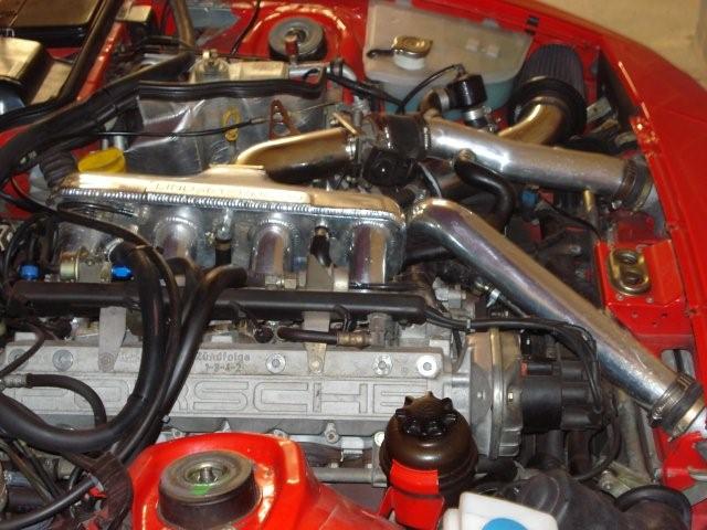

Both Lindsey Racing and SpeedForce Racing in the states make aftermarket hard pipes with smoother curves and better flow, but you'll need to ditch your airbox to make them fit

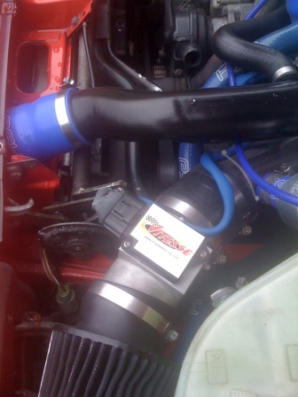

Are you on the standard air box?
Well as you can see in my pic I have no airbox, mine has a MAF unit fitted which no longer uses the airbox. There are many ways to modify the air intake, i've recently ordered a number of items to redo mine which I'll post with pics once completed.

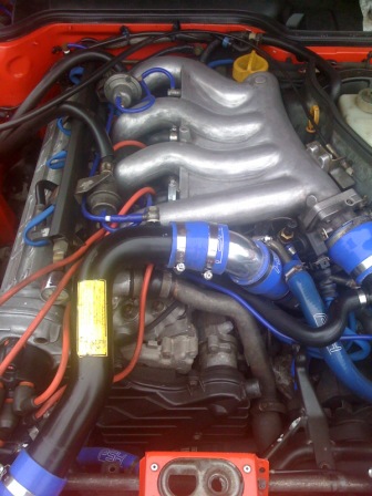

The originals have ridges, my replacements do not and they are blue...[]
Pete - nice engine bay mate. But there is one thing that is missing if I may be so bold..... A nice trick billet fuel rail [
haha... IIRC you had one for sale....[
To be honest it's not missing by chance, I have researched into the billet fuel rails and how they have caused problems with cracked pipe unions followed with an engine bay fire. I believe this has been mainly with the Lindsey rails which I know yours isn't but playing safe so far I've resisted it, having said that yours did look very nice mate...[

I couldn't tell from the pic if you just had the airbox removed or had some other setup
sorry Tom.. here's a pic showing the MAF[8D]
