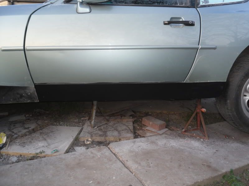

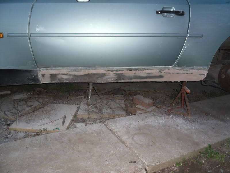

Done abit more, all welding is now done
Just need abit more rubbing down and then its spray time. Ed
Wow... really inspiring to see this work being done DIY style, although clearly you have the skills to do a proper job.

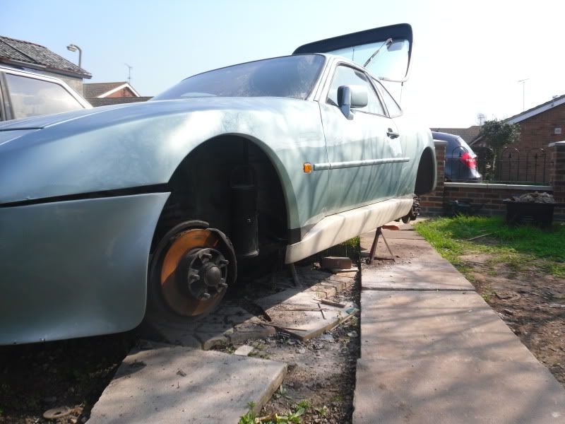

Yes black nasty stuff and lots of it [:D] I got these to put on, I am not to sure on them at the moment but should look ok when sprayed.
Looks great and the sill covers do look ok - all I would say is that you need the wheels out as far as possible to make it look right.
I don't like the way the wheels sit anyway they are to far in so was looking to get new wheels or could get spacers, what size tyres should be fitted to phone dial 15inch wheels? I have different on the front to the rear. Ed

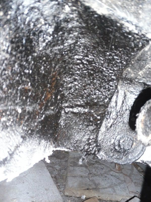

Got the camera and took a pic inside the sill on the drivers side, didnt think it looked to bad

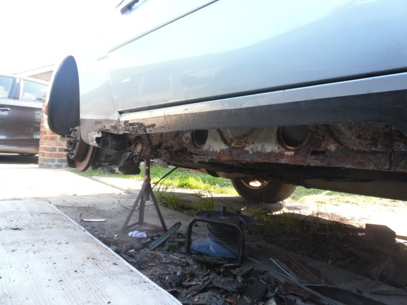

Now my thinking was if the other side was bad then this side should be the same and the answer is.......
So will have to go and get some more steel and mig wire [:)] Ed
