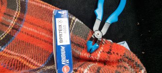

I so today I replaced them with my prefered choice of NGK Iridium IX 7's.

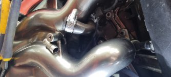

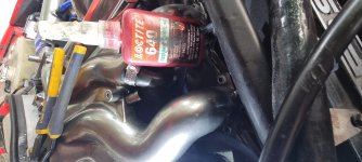

A few things while doing this, first when removing one of the hoses for access to No. 3 plug lead the small tube came out of the manifold, I wonder how long that's been leaking if indeed it was?
No big deal, a quick clean of tube and manifold with IPA I reassembled using a Loctite retaining bonder, in this case, 640 which is a very fast setting type.
Pictures hopefully show this.

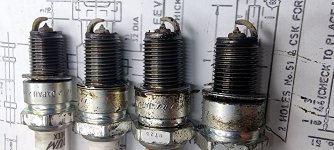

On inspecting the old plugs they clearly are dead, well the top one from No.1 isn't too bad but 2,3 and 4 have large deposits around the probe. The good thing is that all 4 were dry and of a good colour, no sign of nasty oil.
