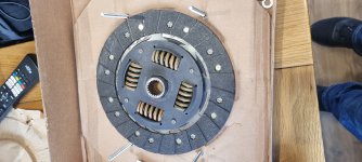

Your post about the clutch got me doing some research and I noted that many rennlist folks were using the Cup clutch up to and around 400hp (I believe, but cannot 100% confirm that this is now the only clutch plate / disc supplied by Sachs, my new kit appears to be this one, it has 4 large springs and none of the helper springs that the older standard one did), and a stronger modified pressure plate (e.g. KEP 1/2) or the Cup pressure plate (according to the Sachs online catalog, this is no longer available). I wonder if the pressure plate supplied in the newer kits is the same or similar to the cup pressure plate.
That is pretty damn good Pete! I've ordered a few things from the US recently and all have arrived within 3 days or so, and I only got stung by HMRC once.
Even better considering this was over the weekend, DHL stated 2-3 business days, which usually excludes weekends. HMRC stung me for £196 but I was expecting something like that, total cost including import and postage was around £1230 which interestingly is about the same as the Helix.
I'm not sure what the cup clutch is these days, the version with the smaller springs was replaced many years ago, and the one already in the car now has the 4 large springs only.
I did check out Helix via Torque Developments who also supply Centerforce here in the UK, they enquired on my behalf what Helix can hold, their Paddle disk holds a max of 376ftlbs which isn't enough. When the car was dyno'd at the lower 368bhp she produced 382ftlb which ok, was at the flywheel but our cars don't lose that much through the torque tube in comparison to other types. The Centerforce is also claimed to have lighter peddle pressure due to its ball bearing design, would you believe their top race clutch is claimed to hold 1300ftlb,, I bet that's a bit stiffer on the foot...
I show here he reverse side of the dual-clutch disk.
Pete
