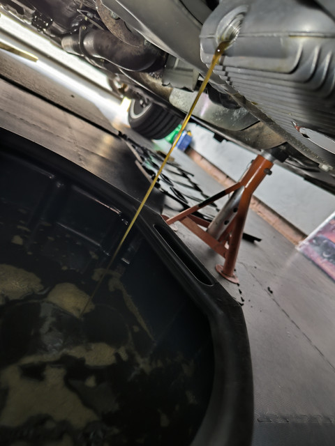

500ish miles time for an oil change and switch to Valvoline VR1 Racing 20W-50, the oil still has a little bit of the Liquimoly assembly lube in it hence the colour/texture (it is a moly-based lube).
