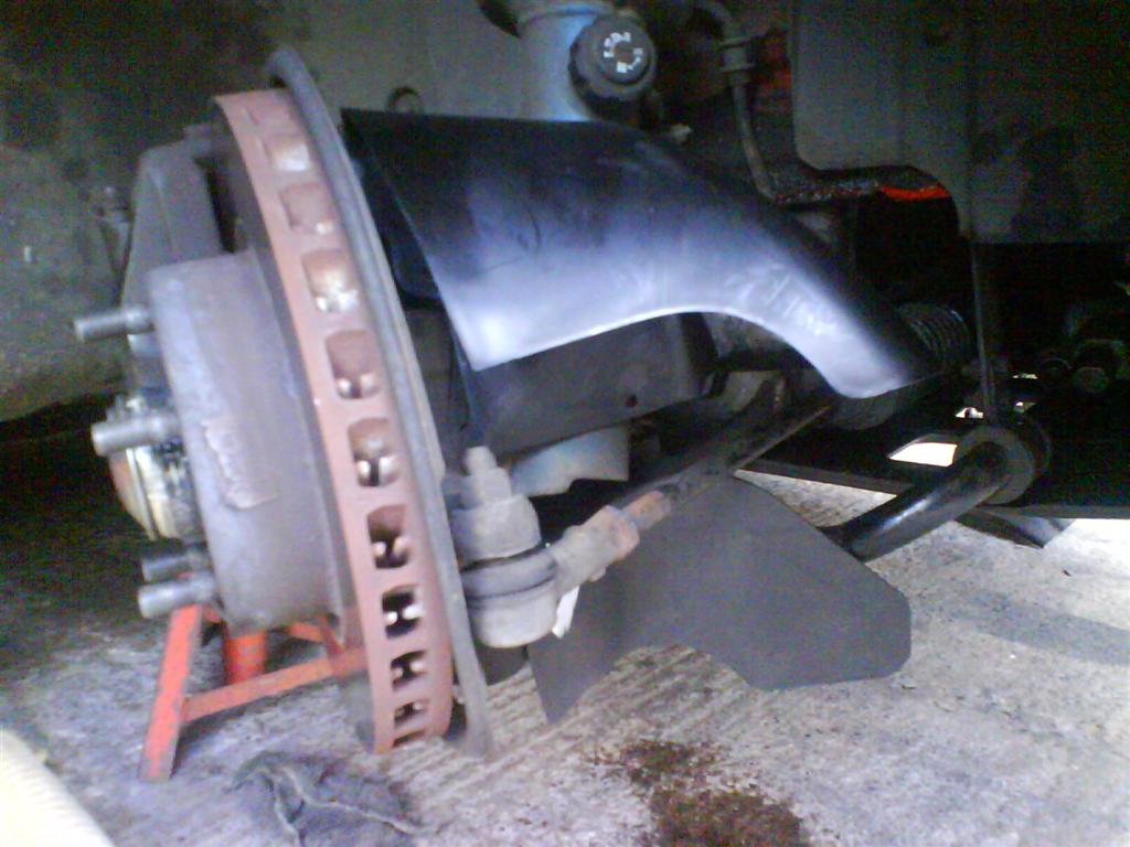

968 Ducts Fitted
- Thread starter edh
edh
ORIGINAL: TTM
Late turbos and S2's did not have 968 arms.
I would bet your car was fitted with 968 arms during its earlier life - just like mine.
The problem with 968 arms is they aren't easily rebuildable as 944 arms as worn out ball joints cannot be taken out without machining the arm.
968 arms have a 944 part no & PET lists these same arms were for '90 model year onwards 944's. - I had assumed this meant they were fitted from new
John - at least the "ears" are in line with the wheels so will get the max possible ground clearance (and they are very cheap to replace). Later turbos didn't have the ducting through from the bumper, just the deflector on the duct. I think Promax are selling the ducting, but it's 3x the cost of this option. The shape of the upper part looks like it will be pretty good at firing the air into the centre of the disc.

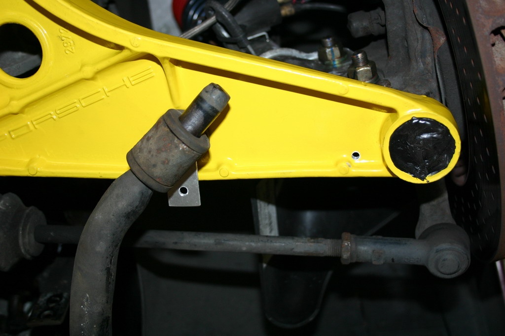

Here is a way to fit 968 scoops to 944 arms :
I am no doubt being overly cautious but it isn't something I would be 100% happy with.
You may find that speed humps are a problem. I found that my car would straddle some humps no problem without the ducts but after fitting them they sometimes catch on the edge of the hump, nasty. Now I slow down and bump one wheel over the hump.
IMHO 968 ducts are brilliant. Pound for pound the best thing I have done to my S2.

One ear is about a tenner - so one of the cheapest 944 parts you can buy [

ORIGINAL: John Sims
[] I'm not sure I would recommend drilling holes in the lower wishbone. I appreciate that it is a very small hole in, what would seem to be, an unstressed area but all castings have a level of internal stress due to the casting process. I am no doubt being overly cautious but it isn't something I would be 100% happy with.
Fair enough - 968 wishbones are actually strenghtened in the area of the hole.
