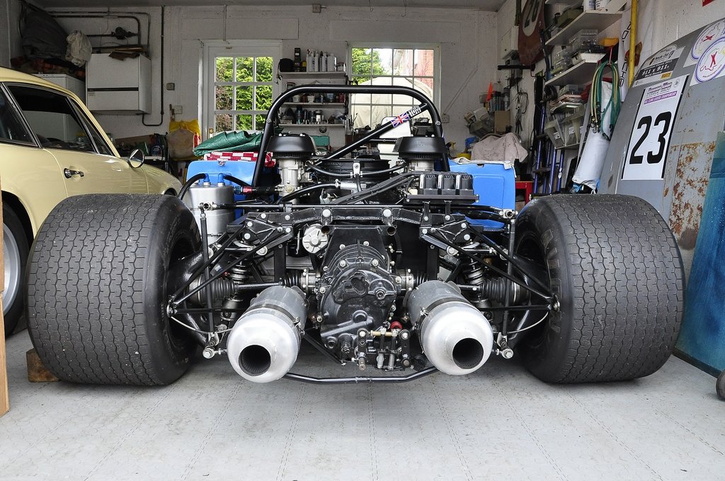

Here is the car with the old 14" wheels and slicks used for the harsh rolling road sessions, the correct wheels are a mere 10" wide and very soft slicks, so can't use them, also £260 each to replace.
