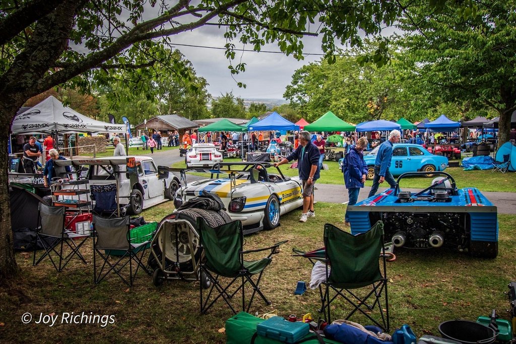

Hillclimb paddocks are always friendly places, nice picture..
ralphmusic said:
Well done after all the frustrations over Winter and early New Year.
+ 1 ...
