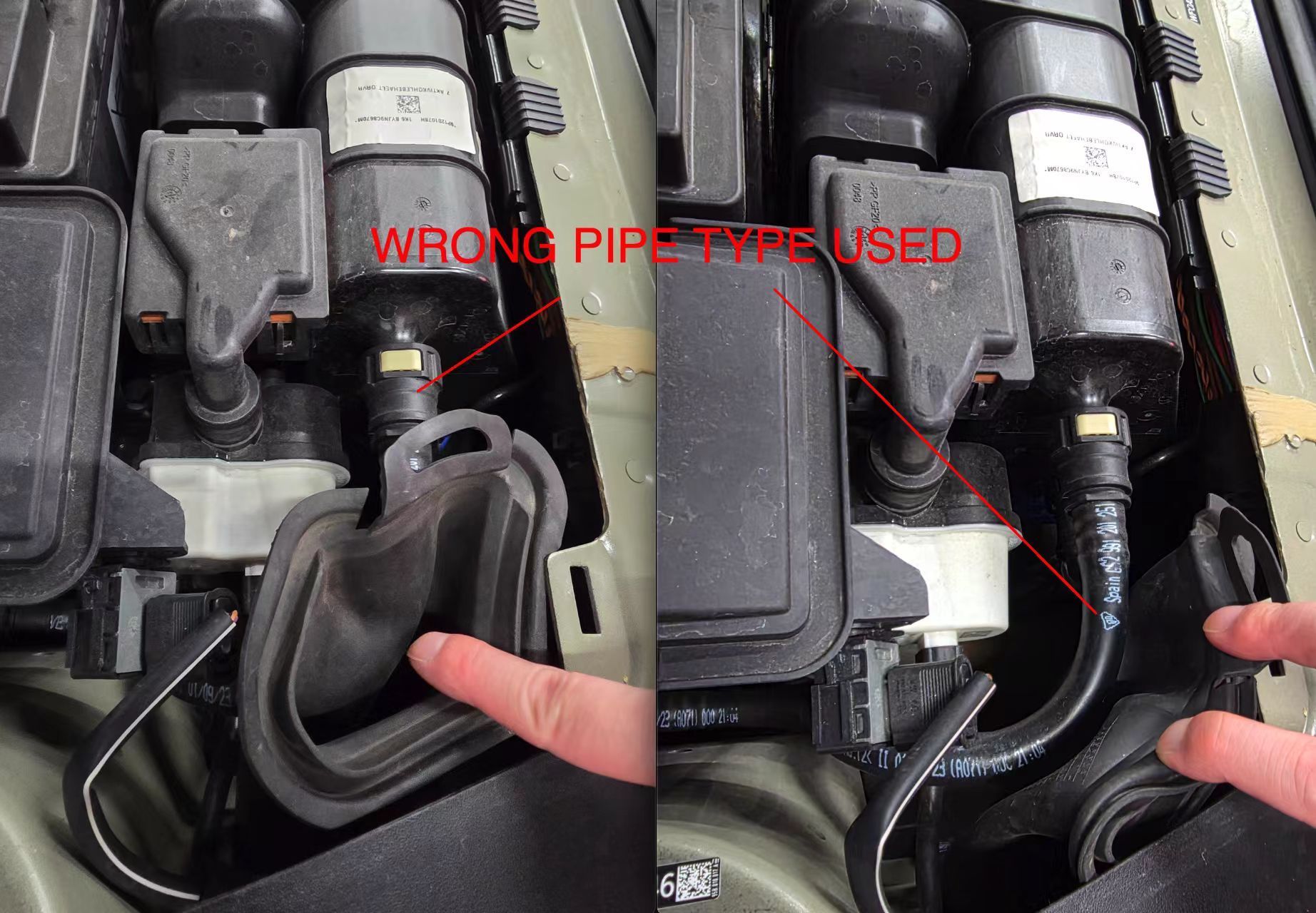

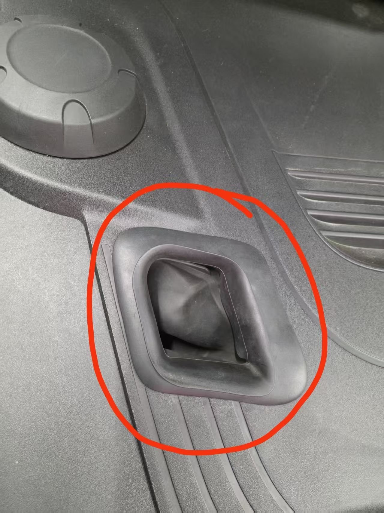

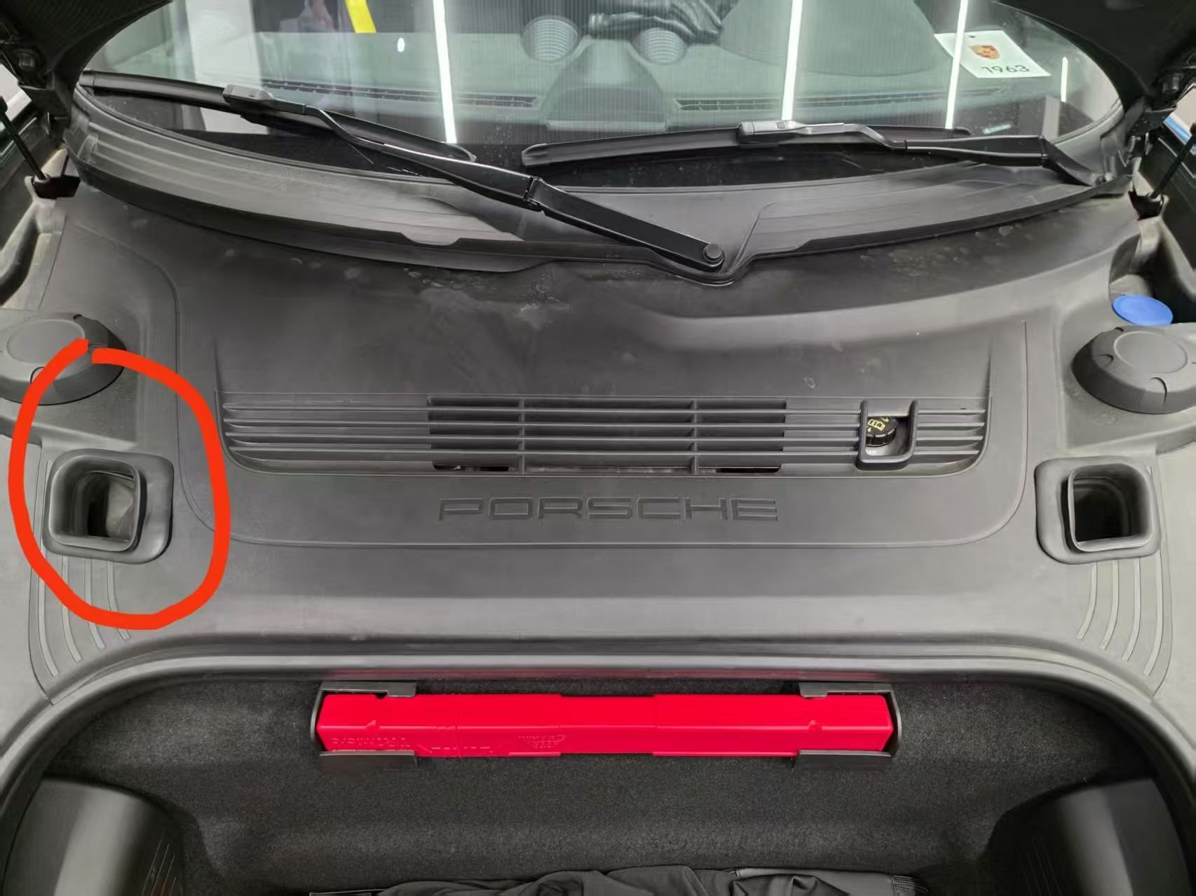

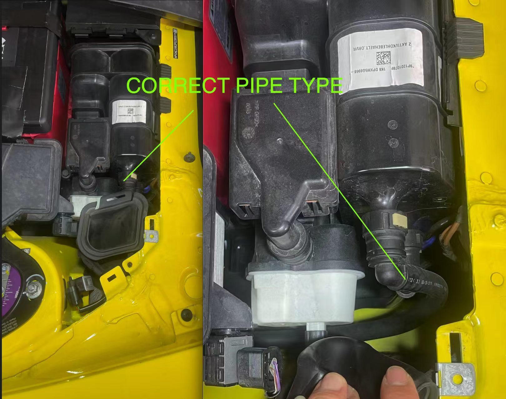

For those with 4RS/SRS, some owners on Rennlist have identified an issue with the front brake duct pipework during build.
From Rennlist
'Please inspect your brake ducts immediately.
We have identified several GT4 RS vehicles produced at the Volkswagen plant that feature a blocked brake duct on the passenger side. Upon comparison with correctly assembled vehicles, the root cause appears to be the use of an incorrect pipe type on the assembly line.
The impact is that the passenger-side brake lacks proper ducting, making it significantly more prone to overheating under extreme track conditions. We have already documented three such cases within our local group of 147 GT4 RS vehicles.
Recommended Solution:
Visit your local Porsche dealership and request a warranty replacement for the affected brake duct. One of our group members successfully obtained a warranty repair even after their vehicle's warranty had expired — a commendable gesture from Porsche in acknowledging this manufacturing oversight.
Brake duct issue found by SilverRocket
May be worth checking yours.
