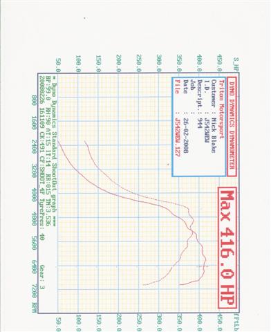

The 2.5 turbo cab that Paul mentioned...
Yesterday it too was on the rollers... 416 BHP, 380 LBS of torque, very driveable and a very happy owner... total cost was around £5000... Even still has a stock bog standard intake manifold... Our mad scientist experiments are bearing fruit :eek:)

ORIGINAL: Indi9xx
The 2.5 turbo cab that Paul mentioned..... 416 BHP, 380 LBS of torque,
Mmmmmm, we need to see them dyno charts (if the owner is okay with that). Better still get him on here and posting about it [:)]
Trying to upload a chart to this forum now... not sure if it will work :eek:)
I will try to get Nick to join the forum... but do not hold your breath as he isnt too internet savy... however he is itching to go to a dyno day and will be at the next southern tipec meeting on tuesday
Also, we are adjusting his ignition timing maps in the next 14 days... so the power may well be going up a bit more!!!!
If your still popping down on friday Paul, I should be able to get you a ride in the turbo cab.. Nick, the owner is desperate to show it off!!
He has run out of modified local Evo's and Suberu WRX's to impress (his mate with a Tommy Mac Evo wasnt too happy either)
