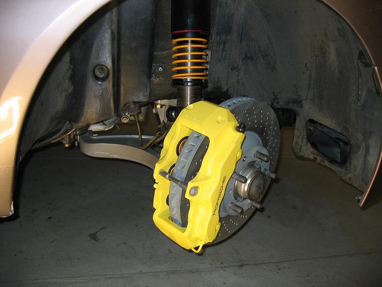

Not so sure I agree with you there on the brakes Ben. Don't forget the reason why Pauls car is in the shop is because his M030 medium blacks appeard not to be upto the job. If you look at the power and torque levels your cars are at compared with the weight and compare to similarly weighted and powered modern machinery you are right up there knocking on the door of GT3 territory. So get saving up for those 6-pots!!
See attached photo of GT3mk2 6-pots on a 944 (not mine unfortunately!)
I would go for 996 or even GT3 callipers if I could find a commercially available adaptor kit but the only one's I have seen fitted to 951's are using custom made one off adaptors that are not openly for sale [:(]. The Big Blacks offer roughly the same pad and disk area and they are a direct bolt on to our hubs but they are a MUCH heavier calliper. I need to make my decision this week as to which way to go, but it's looking like Big Blacks.

Will PCCB bolt straight onto a late off-set 944? - Lovely pictures.

PCCB or any brakes from 996 onwards will not bolt directly onto 944 hubs. Adaptors are needed but none seem to be commercially available at the moment [:(]
I may be speaking from ignorance here (woo-hoo! What's new!) but adaptors are surely little more than a carefully measured and enigneered bit of billet alu, surely?
Given that the calipers themselves don't slide, this should make the engineering even easier?
