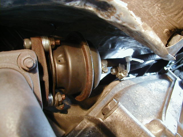

It's a known fact that over time the spring that controls the 944T wastegate gets weaker and opens too early, thus losing valuable boost pressure straight down the exhaust pipe [
] I recently removed my wastegate following instructions at www.lindseyracing.com/wginstal.htm and when I applied pressure to the WG it actually started opening at only 2psi [
] A new wastegate is supposed to hold 12psi (0.82bar) so mine was very weak.

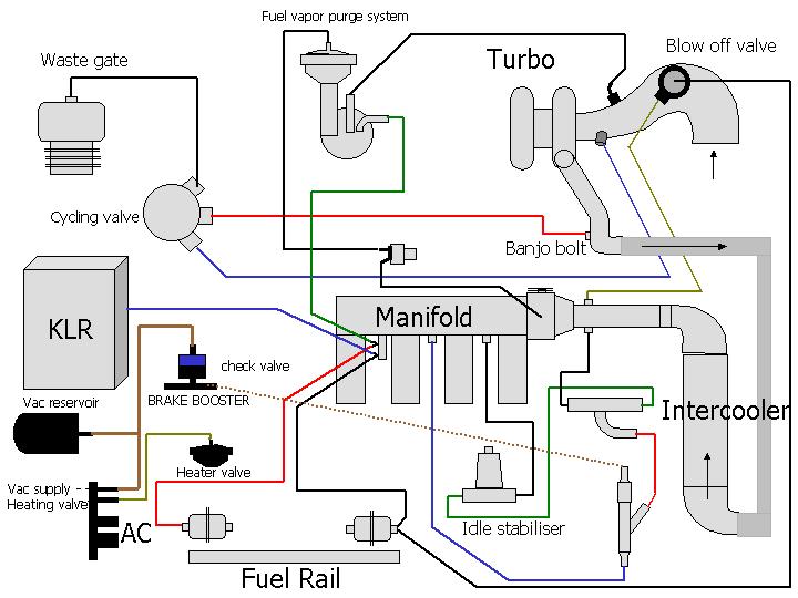

An easy fix for this is to buy a Boost Enhancer valve from www.autoporsche.co.uk At £99 this device is fitted in under 10 minutes and controls the flow of air to the control line that goes into the wastegate to stop it opening too early.

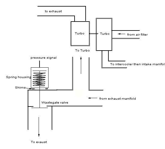

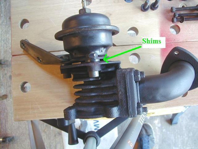

I recently fitted a kit from Guru Racing in the States to increase my boost from the standard 0.82 bar to 1.1 bar. At this pressure the standard wastegate is forced open no matter what valve you fit into the control line, so something a bit more involved has to be done. The Guru kit comes with shims ( three 3mm washers) to fit onto the wastegate to provide some preload to the internal spring and thus increase the pressure at which the wastegate opens. Once the wastegate is off the car you simply remove the three Hex bolts holding the diaphragm to the main wastegate body and insert the three shims.
