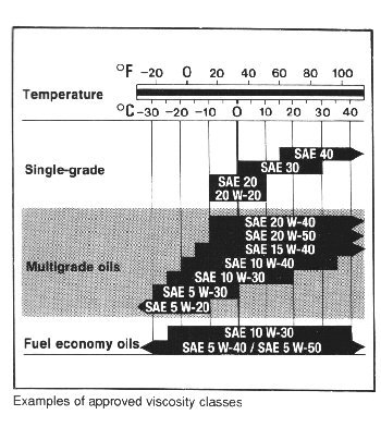

Strange Pat that your manual apparently shows something different to ours. For sub freezing temps my manual says 0w40/ow50. Whilst there is nothing wrong with Mobil 1 it isn't a particularly good oil either. There are plenty out there that are better and have more technology packed into them.
When I get home I'll post our manual. It shows Oil recommendations / temp ranges for Mineral and Synth.
I think we tend to focus on fuel consumption too much when selecting oil. A very big part of what the oil is there for is to protect vulnerable metal parts in a suspensive manner. As the oil gets thinner with heat and load, such as on the track, you need it to remain as much in it's original form. Same with cold start. If you have a lightweight oil it will drop down out of the cam tower and increase wear. Especially if you don't use it regularly.
There was a massive increase in engine wear for some time when many people switched to M1. What lent more weight to this theory was when the wear factor returned to normal (virtually nil) when many of the local workshops went back to a Multi Grade mineral oil with decent viscosity and ZDDP content.
Here you go Scott. -20f for Multigrade oils of 20w/50. Sure you can go lower temp than that and need a lower viscosity. What sort of temps do you get in Winter?
