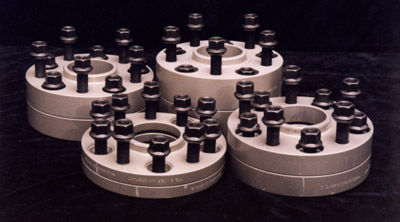

What do we think 15, 18 or 21mm spacers? Could go further next is 26mm but i think thats a step too far!
I just recently bought some from Jasmine and they are really good quality . I used a metal ruller and measured from the edge of my tyre to flush with the wheel arch and ordered that size , allow a few MM for the inner lip on the rear wheel arch
Make sure that you buy hubcentric spacers. The wheels weight is borne by the hubcentic lip, not the wheel studs. Non hubcentric spacers are an accident waiting to happen. You really need spacers which incorporate new studs: to save cost you can fit the long studs with matching spacers from the rear of an early car onto the front, so that you only need to buy them for the rear. The exchange rate is poor now, but the parts you need can still be bought relatively cheaply from Canada/America.

How do these spacer's messure up ? £90 for a pair but as you say , it is very important to fit good quality spacers and they are very light too.
