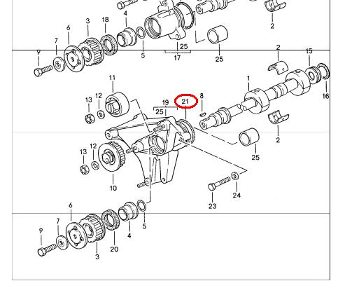

I'm not sure - have you also replaced seal #21?
Yes, I have. The 'Front of Engine Seal Kit' from Promax was very comprehensive.
(Good spot tho' - I was hopeful it was this that was causing the problems, or possibly the shaft seal on that shaft, but it still leaks!)
