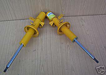

OK then Chappies considering I have relatively new adjustable rears, I have ordered a pair of Koni adjustable fronts from PorscheShop at £660.14 inclusive. Let's see what happens.
I do have an underlying feeling of dread - but that is normal after any transaction of that magnitude.
Is that with the springs? IIRC the konis have a conical spring that is narrower at the top - might also need top perches.

See, that feeling of dread was right - no that was the struts. [:mad:] I'll see what turns up and then probably end up paying for springs and additional postage.
Some sort of foot note on their site might be nice like PS These struts are sod all use unless you purchase the springs as well.
Sorry to be the bringer of bad news [:mad:] IIRC they are blimmin expensive springs as well.
Tony
???????? Do they, why?
They would be if they were conical.............
Found a good photo.............
You are right, they are conical and narrower on the perch/bottom
Are those M030's?
Yup
If so they are progressive rate springs which is probably why they are conical
Dunno Scott. Progressive (I thought) will offer wider/closer spring pitch variants within its height or twin springs with differing rates. If a spring is conical with the same pitch and gauge is it progressive? Must admit I never come across conical springs before.
The pitch of the spring (distance between coils) and the diameter of the spring as well all effect the stiffness of the springs. Obviously Porsche elected to have a conical spring to achieve the progressive rate.
