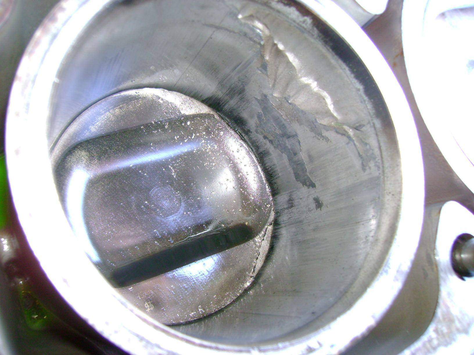

I'd second what people are saying; drop a used engine in it at the very least. It sounds like you have more of your original engine left than I had when my piston broke so you could even get away with just a bottom end which makes it cheaper to buy and also lets you inspect the bores before you hand over the money.

Roger has just sent me this view of the damage.
