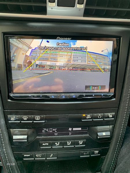

Here is a photo to give you an idea. I am having a front camera fitted too after a year.
The cheaper models seem to have only one camera port. The Hi-Fi end is greatly improved.
Just a question , but has anyone had this done with parking sensors already fitted to their cars? I can ask tomorrow but I was wondering with the pcm gone, how do you adjust the volume?
Quick update : I am going for a pioneer avic 820 , Bose integration , steering wheel contol link, rear camera all in £1400. I think the radio and camera are £850, the kit is £350 ish. Just waiting from pioneer about turn to turn guidance and reversing sensor integration. I like the thought of wireless android auto
Here is a picture with a picture of the rear view with the pioneer camera.
