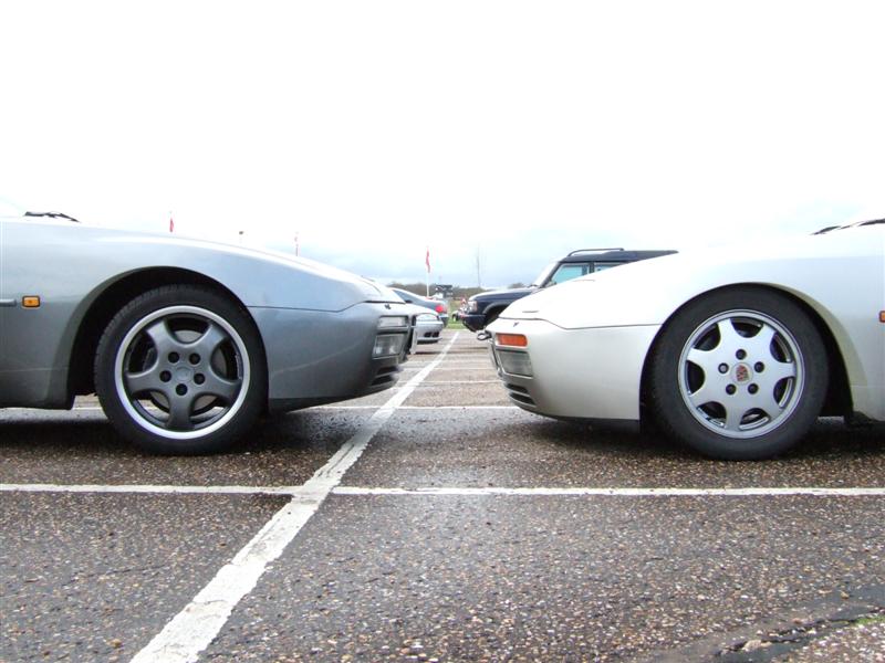

Just remembered I have the original sales brochure for my car and here's a scan that hopefully shows just how high these cars were from the factory. Obviously a dedicated track car with a KW setup whose primary useage is trackwork will benefit from substantial lowering (subject to the balljoints), but my own car is mainly road with the odd trackday when funds allow.
Back to the program, sorry.[
That looks about as low as you can go there Fen. Nice though!ORIGINAL: Fen

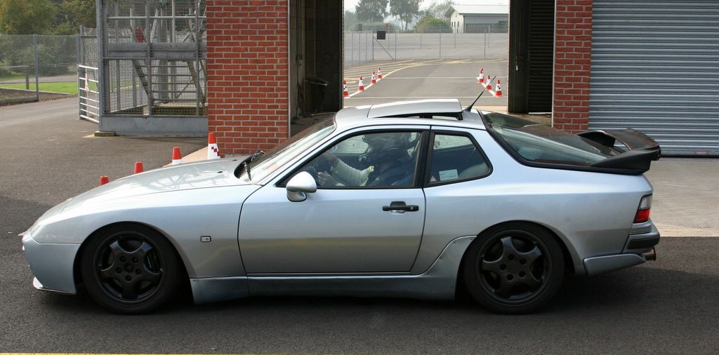

This is a side-on of mine with KW. I have to say I'm not sure what you mean about inner wings being polished, Steve - they should all be the same and I've never heard of that before.
