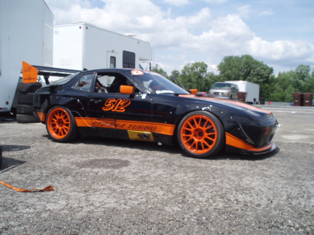

Essentially I would agree with the 'KISS' principle for most of us. Unless you have very deep pockets. Then you can push the envelope quite considerably. I have seen first hand possibly the most extreme extension of a 951 race car. It had a custom Carbon fibre 968 bodykit and resembled very little from what we drive. It was quite something to see in the 'metal' so to speak. They registered over 500whp at 16psi but as has been mentioned, dyno figures are subjective. With all due respect, they do push their cars to higher levels in the US but that's based on there being a much bigger population / market and the costs of cars and parts.
Here's another one that was with the same 'Shop'. More recognisable and financially attainable. However still very fast.
