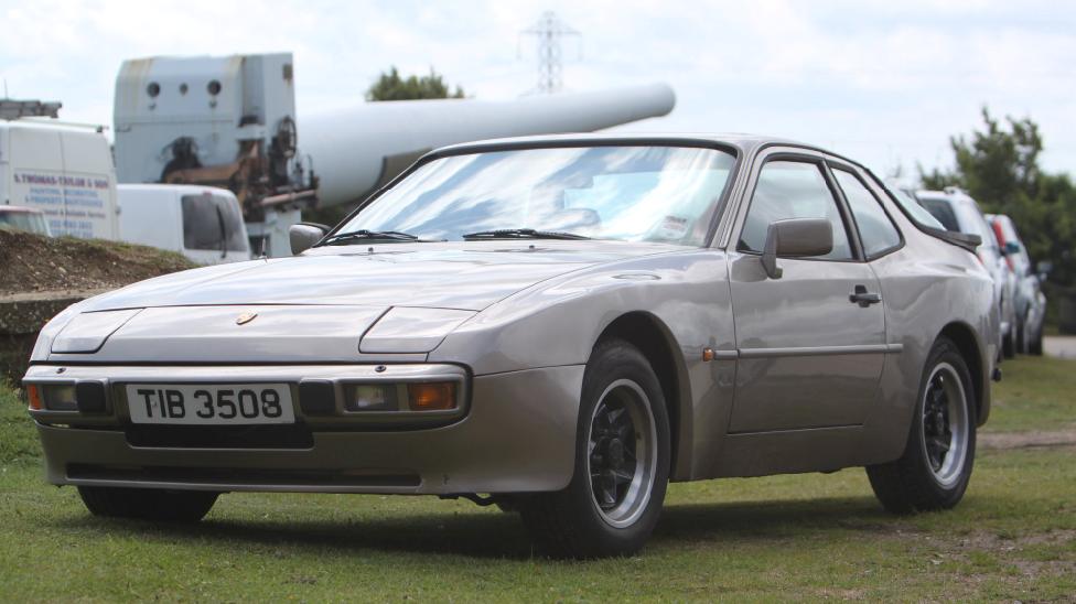

hi you might have seen my 944 on ebay a while ago... well i bought it, fixed it and love it... and finally got to a finish line today when i replaced the steering wheel which was broken (only after buying another one which had a different boss (911?)... so had to swap and restitch the brown leather, (pete) ground off the old rivets to swap the boss... 2 minute job!?)
anyway.... getting to the point... my fuel gauge always shows a full tank... which is wonderful, you have no idea how much money having one of those fuel gauges can save someone...
however, being the cautious consumer that I am and having a mild grasp of the laws of physics I top up my full tank every now and then to make sure it doesn't get less full than it might believe itself to be.... and of course I know that if I unleash the demon around a bend or straight or two (which often happens although I have no idea how..) i was wondering if any of you officianditos know what the fuel consumption figures are for an 8v 2.5 Lux were suggested to be.... I'm topping up at every 125 miles because I can't be bothered to fix the gauge, like the feeling of looking at a full tank all the time and don't particularly want to run the risk of running out in the fast lane of the M27... but was curious as to how many miles I might get out of a tank at (within reason) sensible driving...
